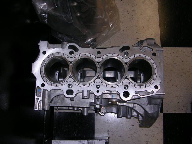

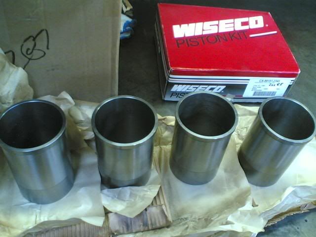

to my understanding, the first thing u should do is to find the sleeve... aka block guard and other different name. Then i guess most of the engineering shop that does machining work for engine can do it. It's just a force fitting method. just rebore and pump in the sleeve.
hehe bro, if im not wrong, block guard and sleeves are diffrent things
lets take vtec for an example
this are block guards
theese are sleeves
theese are sleeves
Right... thanks for the correction...
