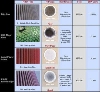

some one posted this loooong ago before. maybe a sticky is needed.
no filter la shiok....turbo sounds damn ganas.
