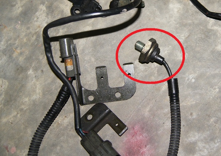

Bro your mivec is in limp mode.Got Rev Cut
If you do ECU diagnostic knocking sensor will show CODE 31 as shown below,I don't thinks knock sensor is the same as MIVEC Solenoid.Anyway below is knock sensor.I have 1 spare if you want.PM Me.
Detonation Sensor/Knock Sensor

OMG...Bro!....from the beginning the ECU diagnostic was showing knock sensor faulty CODE 31...i thought all this while,knock sensor is solenoid sensor...I found the location of the sensor that u posted from my spare engine...Next weekend i will be opening up d engine again...will update u after i replace it...bro if it really works i owe u big time man...

Back to square one...I replaced the knock sensor with my previous engine's knock sensor but no luck...STILL RPM CUTTING AT 6500...Im giving up already...Anyone with any other solution?Is it possible that the knock sensor from my previous engine is also faulty because after changing the knock sensor and did ECU diagnostic...SAME ERROR...KNOCK SENSOR...help guys...thanx...

have u checked if there is any signal in the knock sensor wires? worth a check since there are two knock sensors dat doesnt work, highly not likely
Hey bro,how can i check whether the sensor is working?Because if im not mistaken it will send the signal to the ECU at 5,500 rpm right?Do i have to connnect the earth to the battery terminal,then connect the positive terminal to the wire coming out from knock sensor and rev my engine above 5,500rpm?

knock sensor works on all revv sir, just check whether there is any signal from the wires
