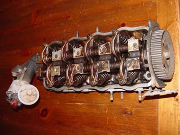

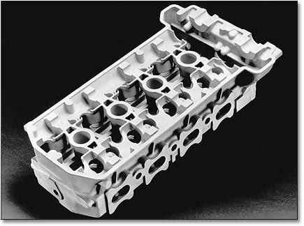

burnner u dont get it... i mean only cylinder head not combustion chamber...here`s example of the cylinder head pic...how make it clean from all the dark colour...

it's call gum deposit.usually from a cooked cylinder oil(this is what happen if
u guy's don't change the engine oil regularly as recomended by the manufacturer).
usually we scrape it off.i wonder whether the acid from paint remover can clear
it off?
Buy this thing:
http://avtodeli.enakupi.com/large_image.php?productid=16727
Spray it all over the black shits
Heavy duty degreaser, the ones they use for chemical wash for air con., and the same thing for engine bay wash! Just have to spray few time n let it soak for a while! and then rinse off with water!! Other then that they use paint thinner to scrub the grease of??
Thats all I can think of cause i dont have the chemical name of the top of my head!
Best of Luck!

i thought people usually jz use petrol and a brush to clean the head from dirt??...
This wut the mechanics in North America do! A basin with a steel brush hooked up to chemical! SO while u brushing the parts(cleaning) the chemical is sprayed thru the brush! Ya can try petrol, but it smells more like a paint thinner if want to b exact.....I dont record the chemical name but just remembered being told its very expensive! Hmm maybe acetone in a dilute form,something just erosive enuff to remove the clods.......other then that a brush with petrol= Happy Scrubbing!!
