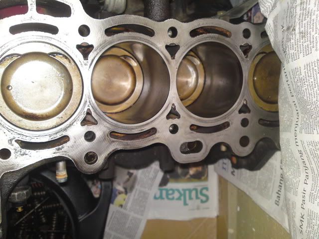

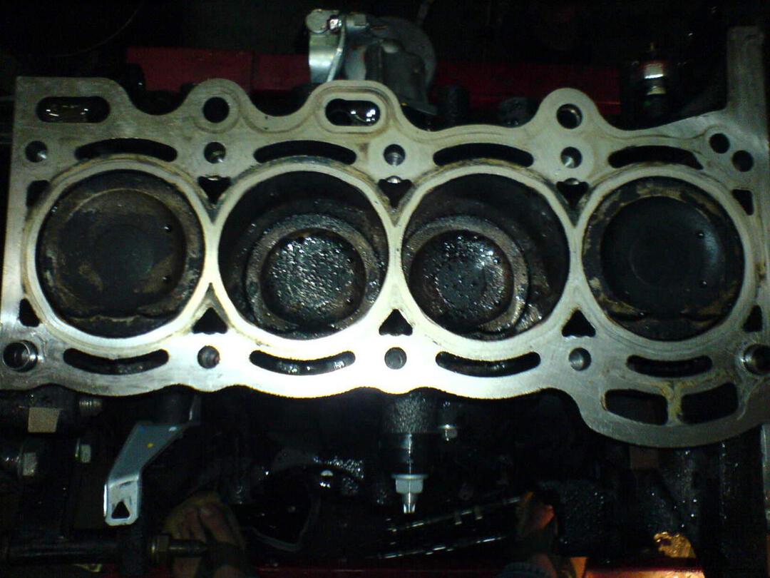

i attached pics of the original piston used on this mod...judge it with ur own eyes bro...never been changed
thanx for that..now it is clear..it actually grind the piston..not the head..seems the piston already got 'kawah' on the top. thus the compression would be lower. standard myvi piston is flat..compression 10.1..
bro...impossible to grind the piston...we also amazed when we dismantled the head and found that the original piston of Myvi SE is almost same as L500 & L200...under groove so deep we thought it was underpowered...we really did grind some area in the head to lower down the compression...u can check with other Myvi owner whether their piston is same like this one...:hmmmm:
