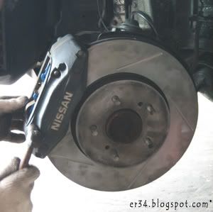

On my R34 GTT, the discs were warped as I can feel intense vibration everytime I brake hard. After which I got the disc skimmed and slotted as below.
After a couple of weeks, the sympton re-appeared. it's not as bad as the first time but the steering vibrates whenever I brake hard. It's annoying me to the max and my mechanic says it's a common problem with Skylines. Is that so?
