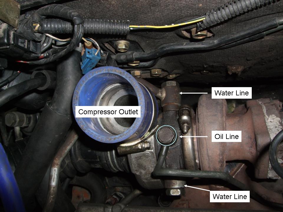

Wanna ask, based on the picture, which water line will be the inlet for water into turbo? and how about the oil line also? is the one showing in the picture is the inlet for oil? or the one at the bottom?

not sure about water line...
but oil line marked in the picture was the inlet..
the outlet was at the bottom to ensure free flow of oil to sump....it was same on all turbo....return oil line on the bottom :adore:
