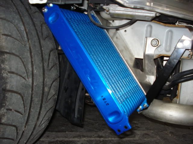

In comes the transmission cooler. Most stock automatic car transmission coolers are just a single line of copper that's part of the radiator located in front of the radiator which quite frankly is useless for cooling a hot transmission. Aftermarket transmission coolers are essentially mini radiators that have more cooling fins to help cool your ATF.
