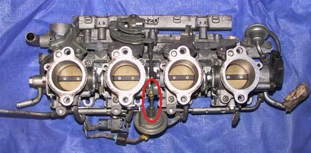

where location of tps? and i found 1 screw at the centre (between 2 and 3 throttle body). What is that?
