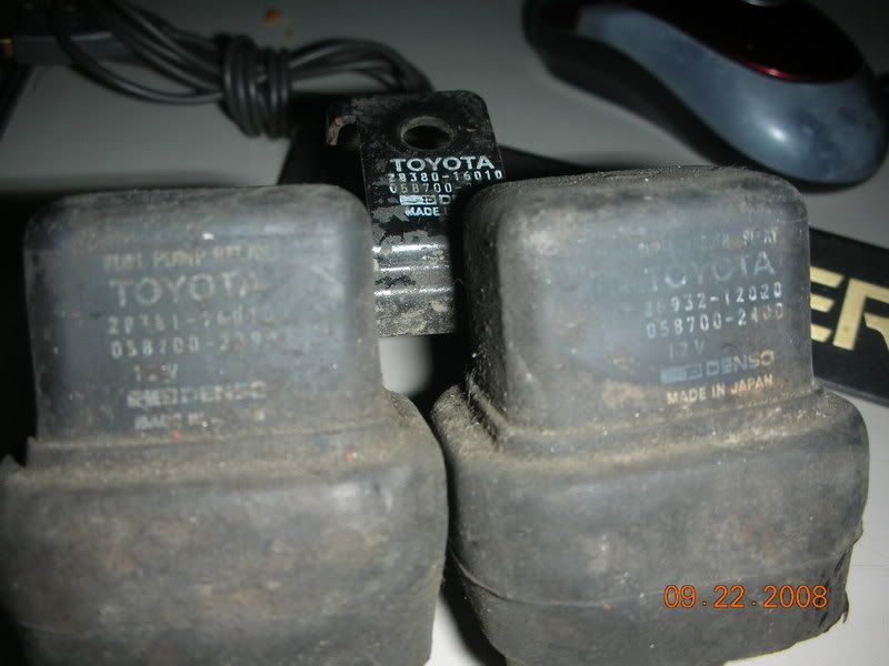

SC relay and Fuel Pump relay.

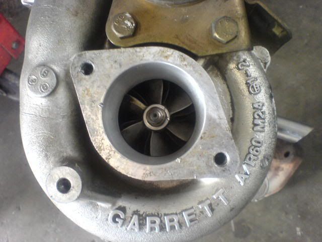

This is the turbo i use

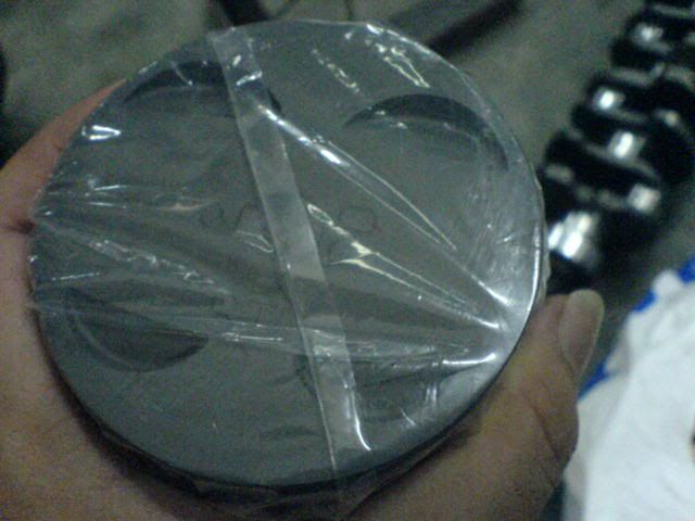

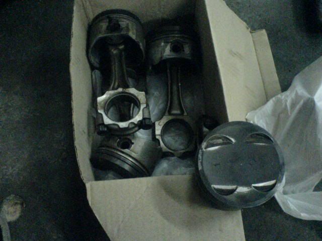

i change a new piston because my old piston cloting melt already

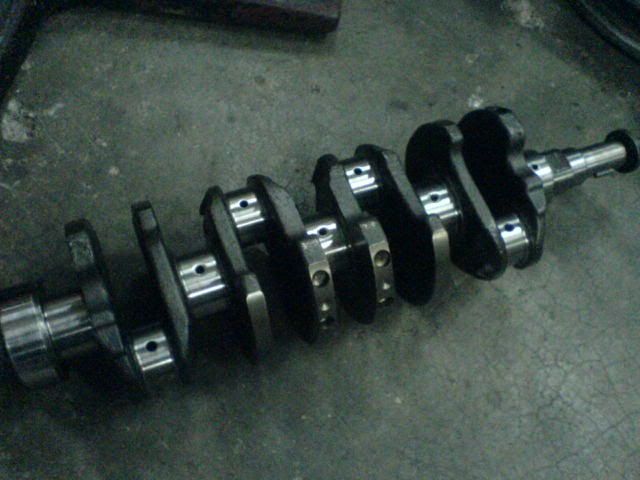

than my crankshaft bearing also worn le.....than repair it also..

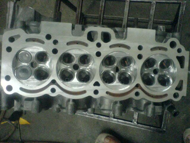

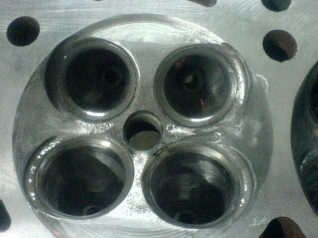

my engine head i port and polish and make compression so i can get higher boost ......

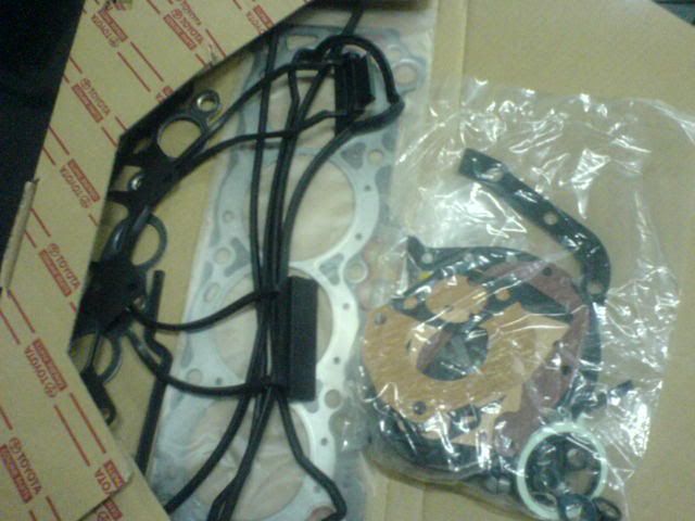

than i bought a full set of casket for 4agze.......quite expansive really sakit a...

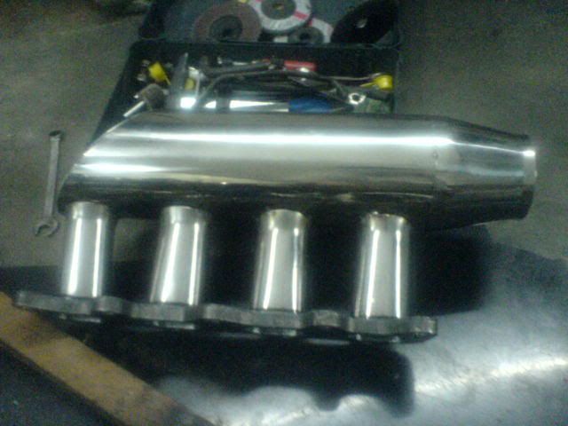

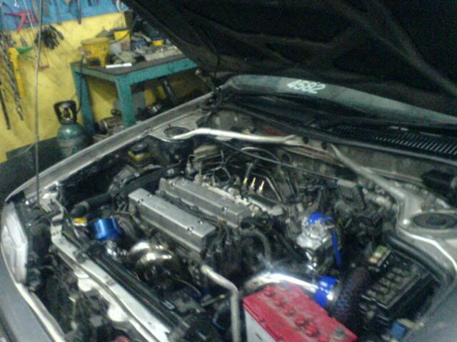

Mnay chop shop cant find the ori 4age inlet manifold wit throttle body... found many shop i fed up le....so i custom made a inlet manifold...

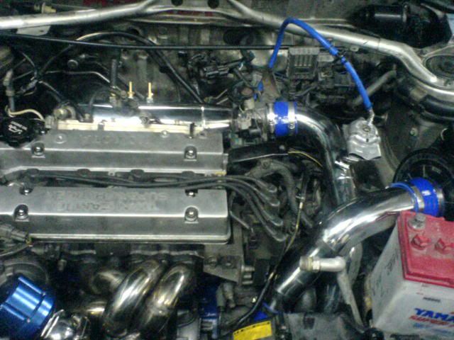

than the last is the intercooler piping

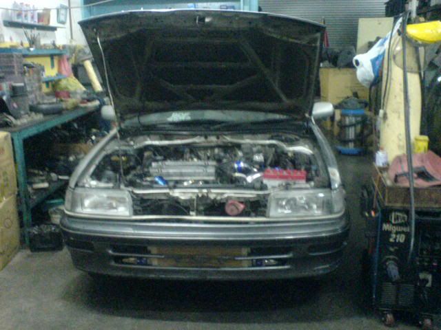

my ori 4agze engine....
Bro M@ntis..... fuyoh! I love wat u did to the custom made throttle body :adore:. how much is that? do u mind giving me the design structure? i might want to make one for myself also.
im thinking of using TD04 from GSR 1.8. I bet its good enuf to boost till 1.5 bar. WHat extractor are you using there?
Miriguy.....u wan the inlet manifold structure.....tomolo i go and measure the size than i tell u wat measurement is that inlet manifold.......
if u wan to use the td04 to boost 1.5 bar .......i don think the the turbo will last long.....my friend's mivec turbo he using td04 his max boost is about 1.1 bar only and a vios turbo using td04 also 1 bar only.....if u wan get higher boost go for bigger turbo....
bro M@ntis, your fren TD04 from what car? Shud get TD04 from GSR 1.8. thats the best suitable turbo.
all from gsr de ....the manual gsr twin fin de....td04L......
7heaven i don no wat is my compression i go ask my foreman ........for the compression...
