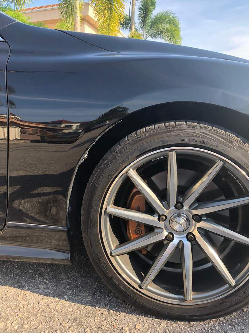

Mine is Vossen CVT, not sure offset.
Just get suspension checked yesterday at the tyre shop. Lifted my car and checked all bushings and rubber parts. According to the mechanic, everything is still in good condition. He suspect the tyre might be the culprit. The thread is wear off to one side for front tyre and alignment is off a bit. Currently using dunlop formula d05, come with the car from previous owner. Its 2016 tyre and initially, I also not really like this tyre becaue its noisy. Now, korek tabung for a new set of tyre.
