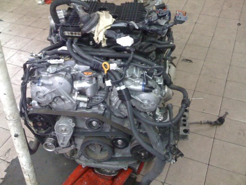

since i'm doing some mods on my car now...while swapping engine in progress from 2003 engine(VQ35DE) to 2007 engine(VQ35HR)...i've notice some different between this two engine..
as we have been told..there was 80% different between old n new engine that nissan putted into our Z...so here i share something in case got some member going to own 2007/08 350Z..
1) of course new engine VQ35HR come with dual air intake system..so it is totally different from VQ35DE..kinetik plenum V+ and HKS Suction Kit cannot be use
2) pulley system also totally different bcoz new engine using single belting system instead our 03 engine using double belting system. Because of this i cant use my lighted pulley anymore...wawawawa
3) cat(catalytic converter) and extractor also different..
4) for manual transmission fan....clutch plate for VQ35HR totally different n unique until now japan still not produce any clutch plate for this engine model yet. Only U.S
5) coil system still d same but VQ35HR is using smaller spark plug..
6) radiator+fan also different...so in case ur radiator fan not working..only can use radiator fan which made for VQ35HR only..:biggrin:
7) lastly..braking system also different since this new engine produce more power than old engine.

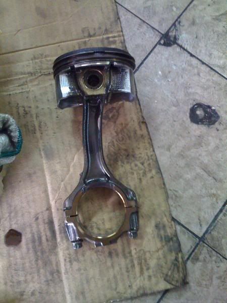

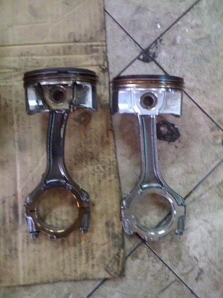

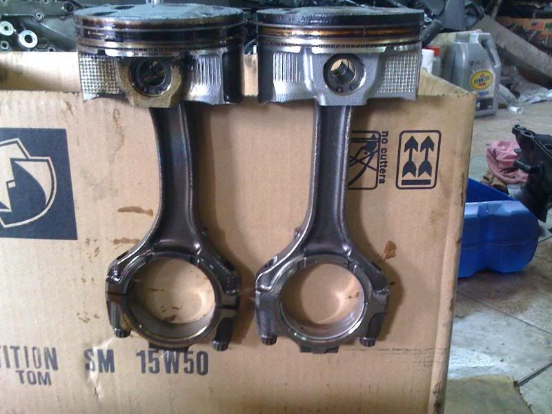

finally found out dat conrod for vq35hr n vq35de is totally different.
But very sad news to me..:bawling:
And after almost complete with wiring...n then they started d engine...then we heard some weird sound...n need to dissemble d engine...
here what coz d sound..
since d conrod different from vq35de...so chop shop have no choice to replace me new hr engine...hopefully everything will b fine this time..:smile:
guess they need to order the new set of conrod for u edi :)
if the chopshop fella wanna kawtim for u asap, 1 week the item can arrive from japan edi :)
i dont want dat engine anymore since they already dissemble it...:biggrin: thanks God they replace with new hr engine...
be sure to post some pictures lord1700
yes boss..sure i will :smile:
That conrod condition show one thing
either the engine been overheated before
or flooded before
or flooded before
d halfcut is using NOS when it was at japan...maybe dats coz d overheated...but all other conrod is in very good condition...accept dat one..:hmmmm:

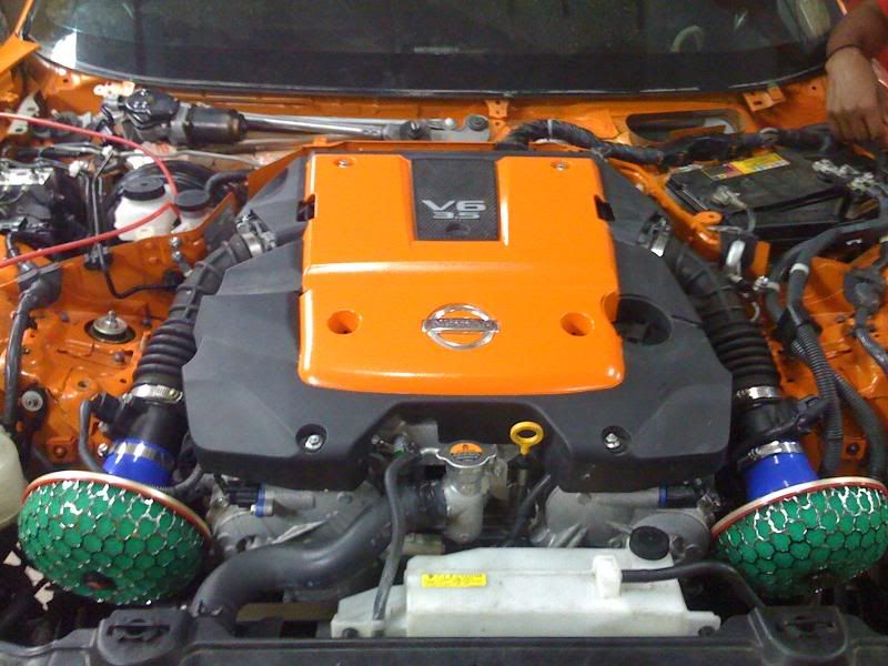

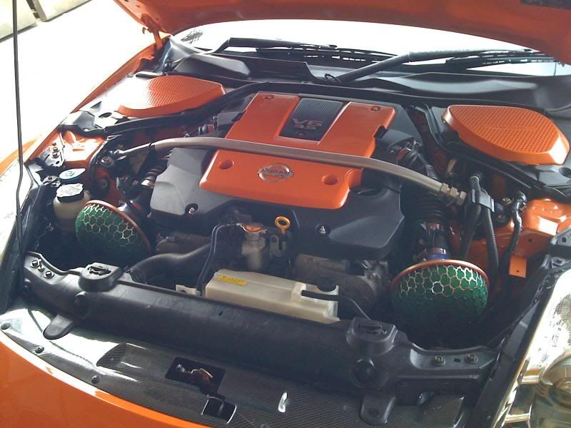

if u wanna see d engine..can go to super gt section....got my car pic there..d orange engine..
http://www.zerotohundred.com/newforums/super-gt-japan-gt/283047-super-gt-2009-roadshow-%40-kl.html#post3599718
other pics i will post soon...now finish up some small things like audio, alarm system n etc..

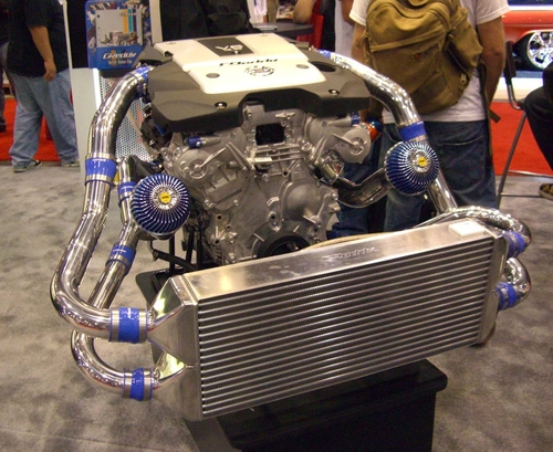

right u r..cannot put turbo on gals..:biggrin:

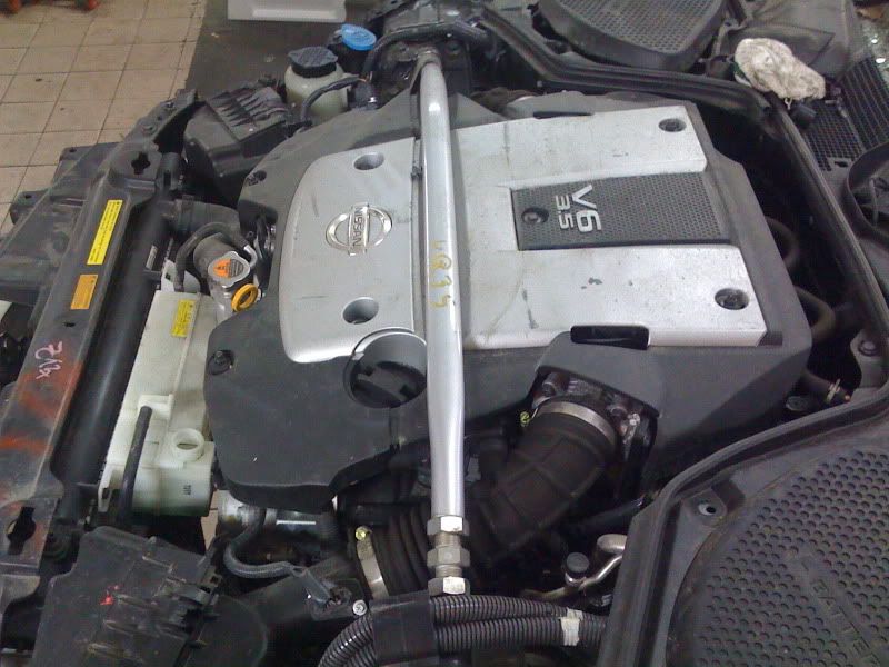

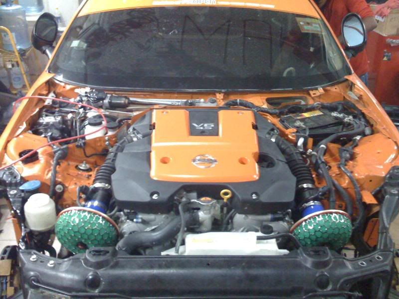

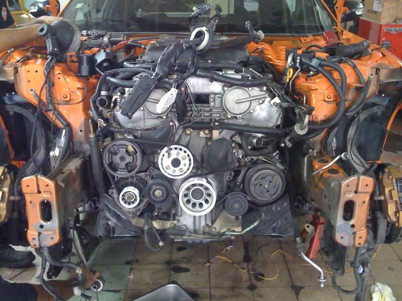

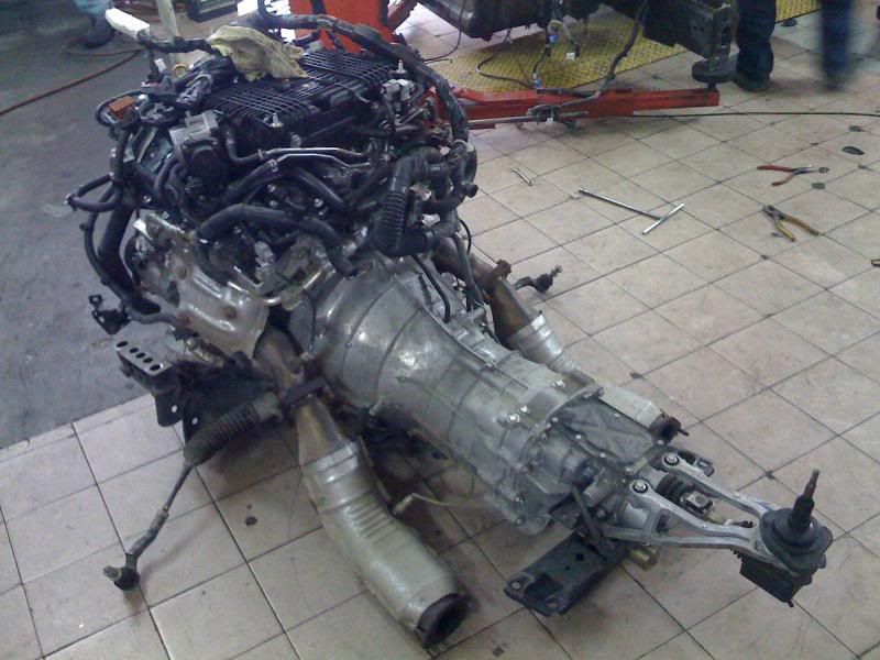

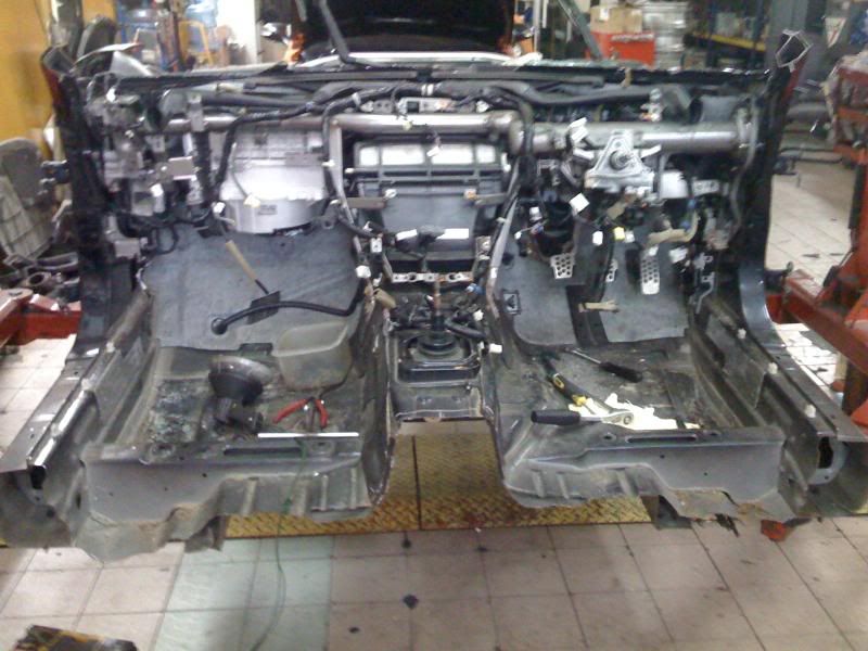

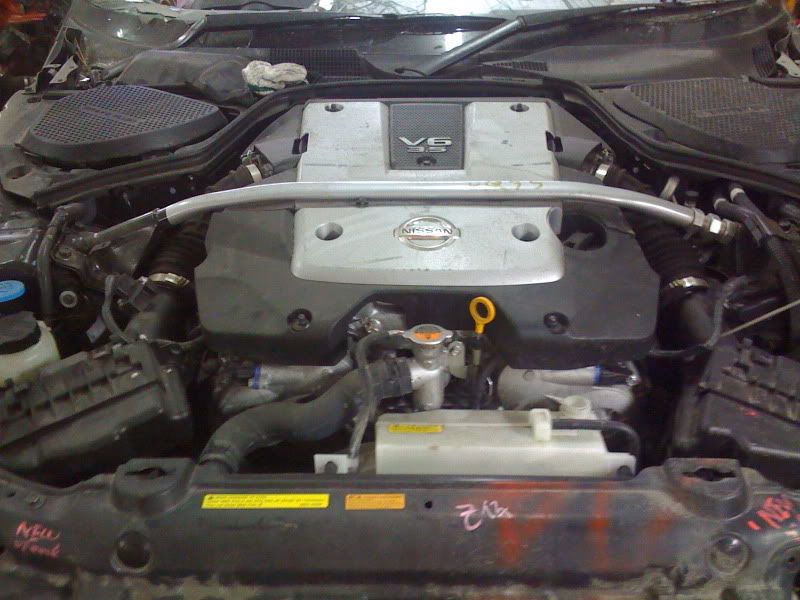

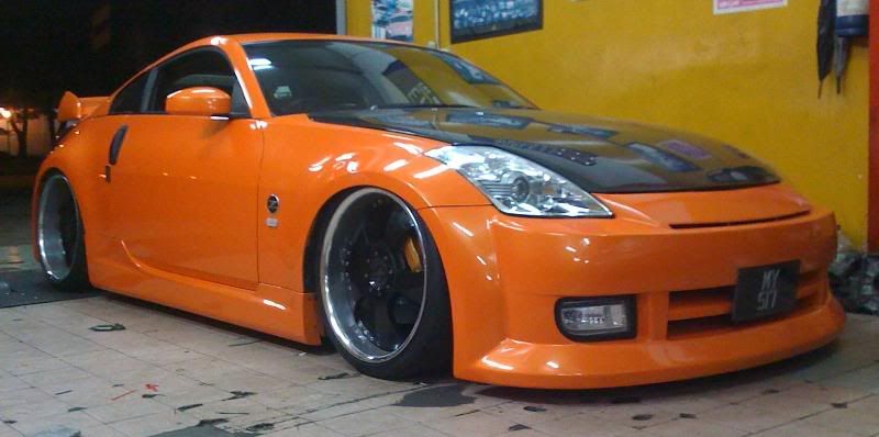

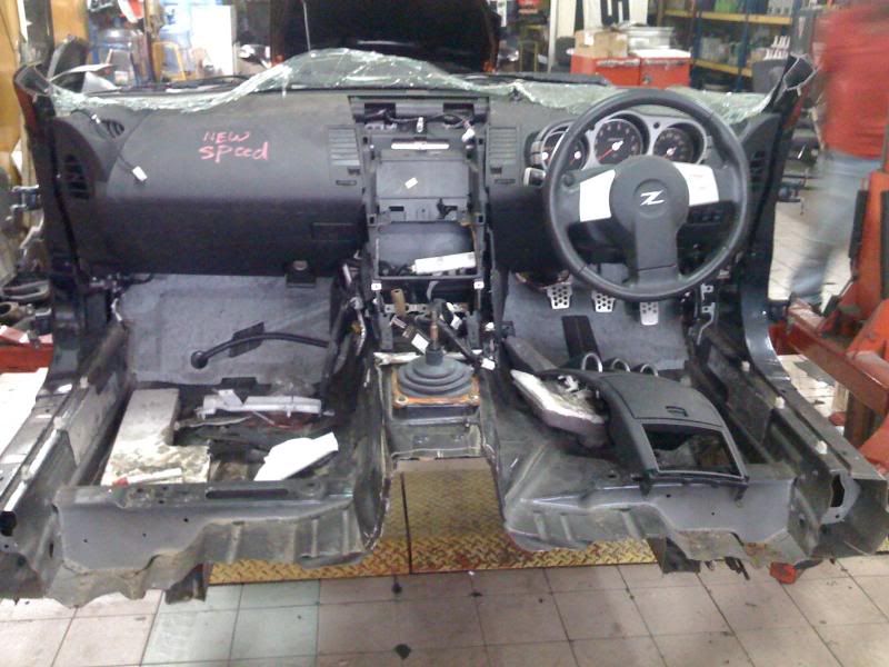

Bump: Posting some of d pics dat i've took before n after the engine conversion...:driver:
The car before d process start..

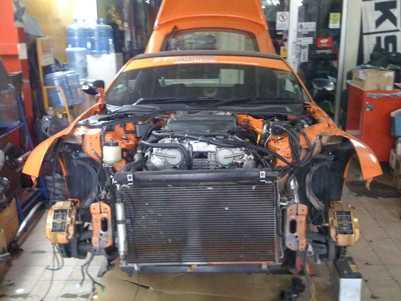

then d process started....

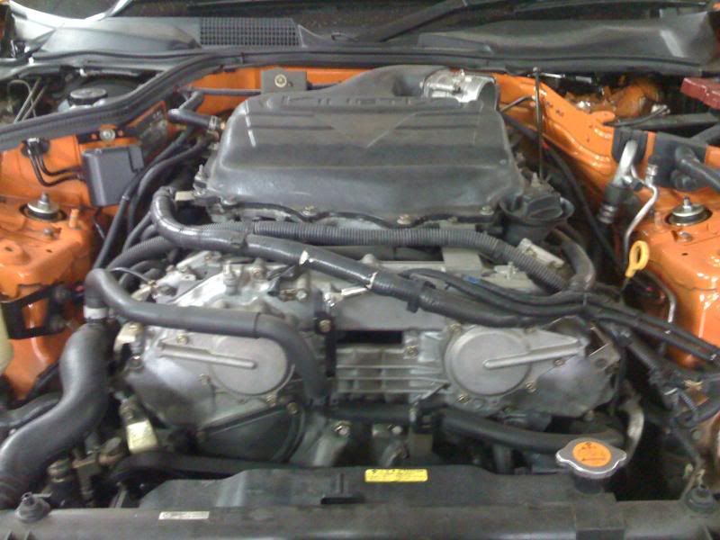

the real deal...
Almost done..

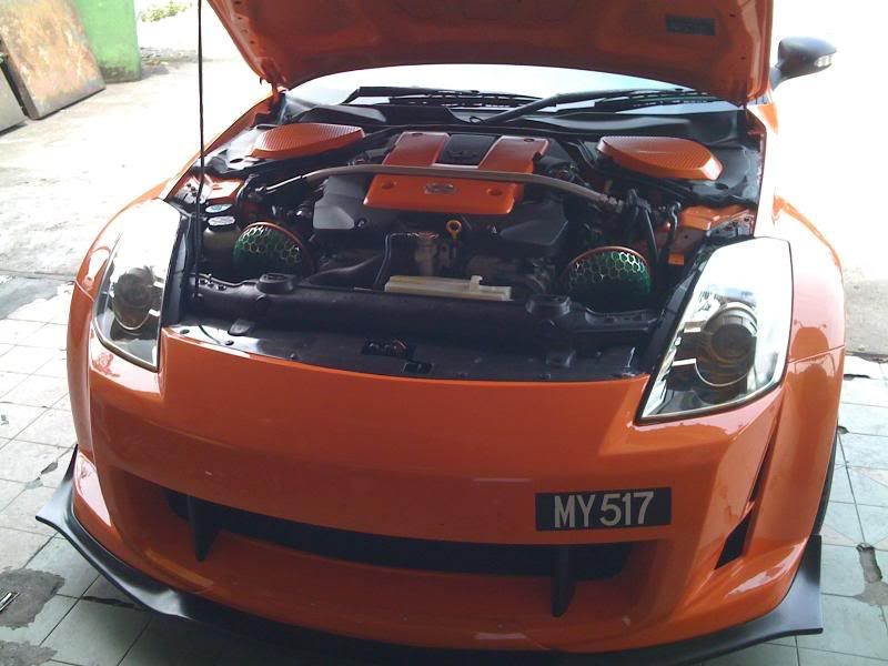

Bump: DONE!!
enjoy!!:driver:

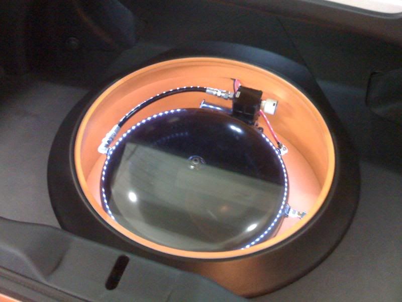

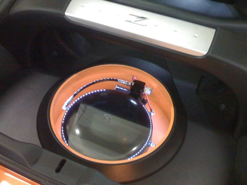

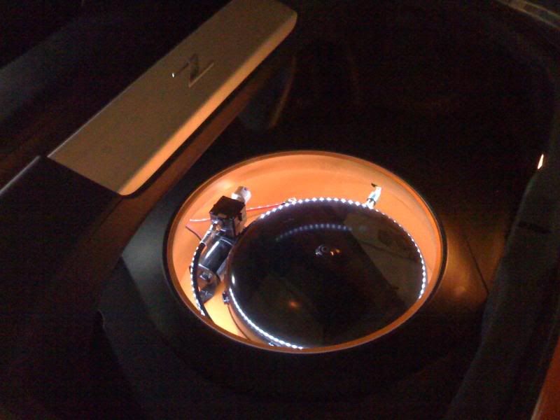

Bump: The air suspension tank..
Max lowered!
