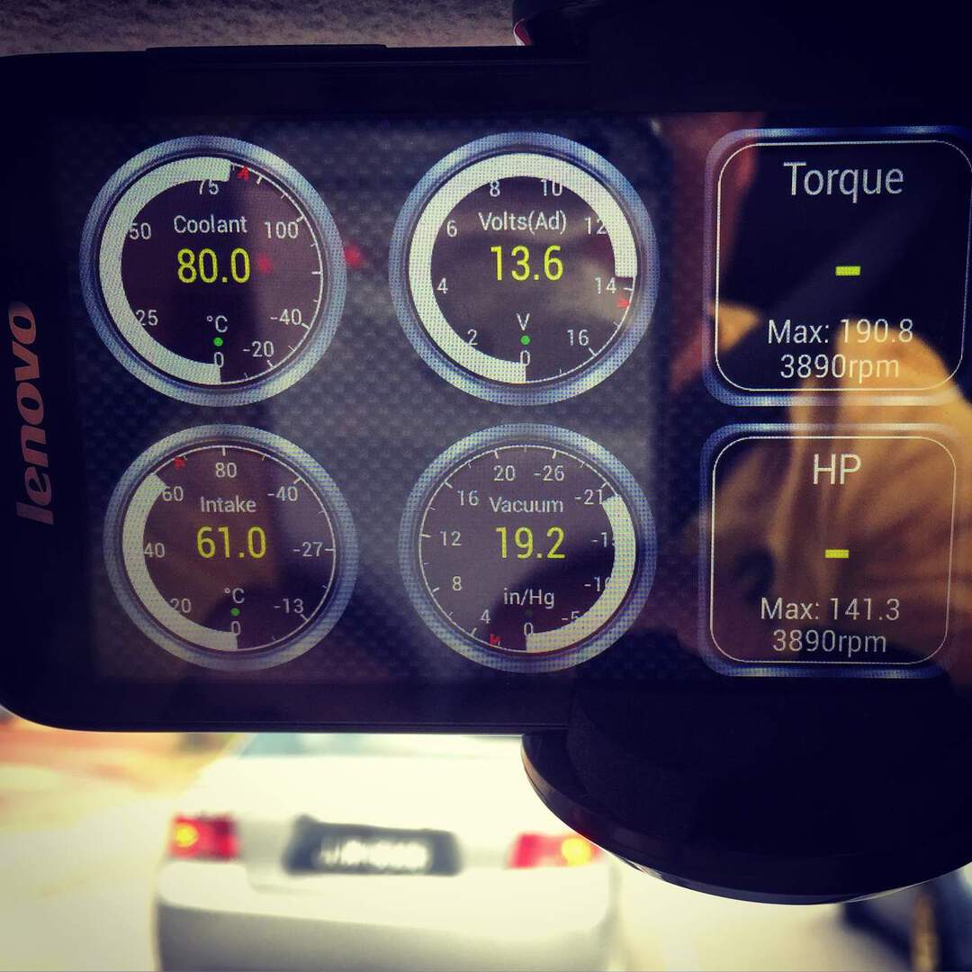

So the radiator is aluminium type + sensor driven fan controller. I have never really measured the temperature until last week when I got my son a new cellphone, I took his old one and bluetooth-connect with my OBDII reader (which I bought to check engine codes last time) and took a trip out of town. I was pretty impressed.
Observations
- On hot afternoons traffic jam, the highest water temp reached was 88c.
- On hot afternoons driving, it hovers around 77c-80c
- On cloudy afternoons driving, it hovers around 69c-76c
- On rainy days, it goes as low as 65c.
I think this mod is important especially those who is running bigger turbos and higher boost. Cooler engine will reduce pinging.
Intake temp however was high cos I am using open pods.
- On hot afternoon jams, 66c!
- On hot afternoon drivings, 45-55c.
- Rainly or cloudy afternoon drivings - 36c-45c.
I may need a Cold Air Intake I guess. I might also swap back my old airbox and test it.]
Hot afternoon traffic jam.

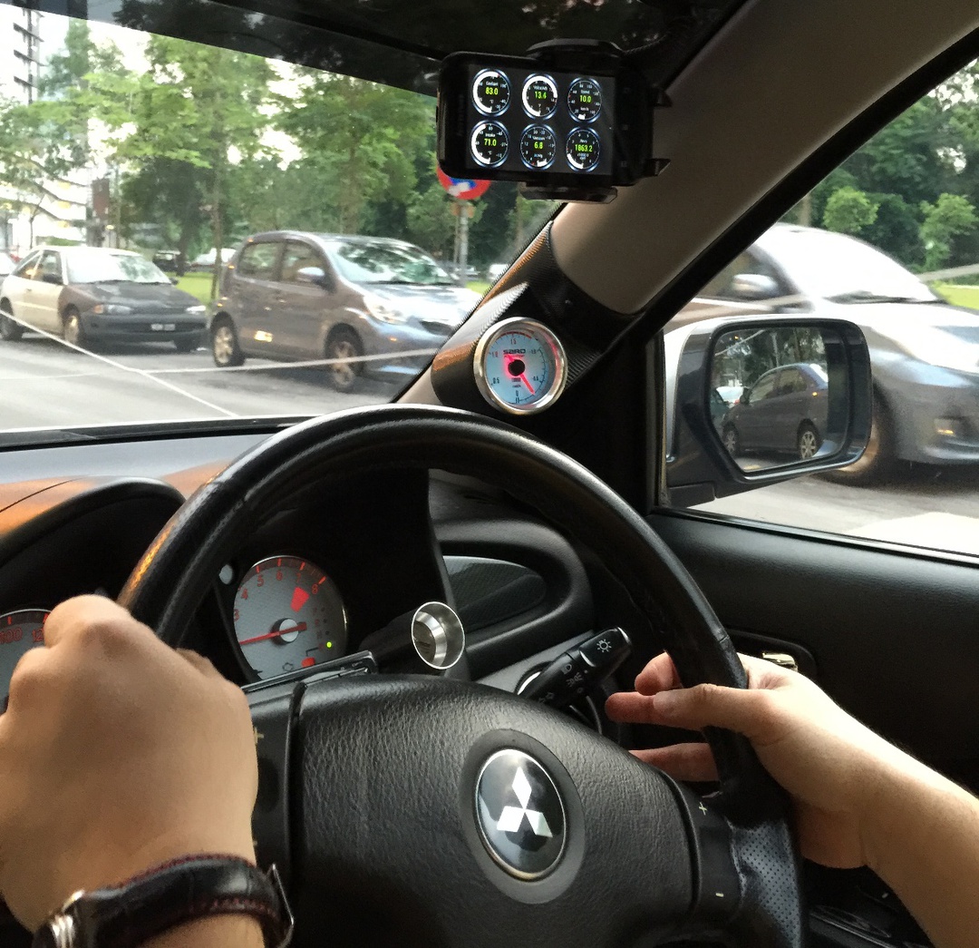

Me driving with OBDII Torque app running. Hehehe..
