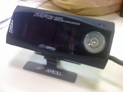

Since I am receiving too many pm's regarding the PS Power product vs other managements
I would like a decent , constructive thread where someone could come out and tell us all why the PS Powersport is an excelent product, please help me, im stupid , i want to learn from the PS guru's
would like to know the tuning points , the features of the products, the advantage , some PS guru's even said its better than standalone ecu's, errr i wonder how , educate me
Can I know Sir
what is this
in comparison to this
or this
or
educate me Masters , im a newbie
or maybe this
PS Powersport Air Sensor Convert vs Microtech MT4 where both u ditch the air flow
