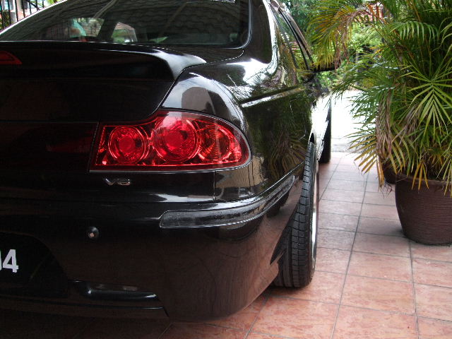

aiyo. u should have taken it. what rim model?
sagat sikit je. if u skim the bumper a bit, no sagat la..
yoko avs, the 5 spoke design.
this is mine. not sure 35 or 32 offset
saw ur pic before this. the rim are out of the fender thats why I thought it would sagat the fender. plus I always bring along my parents.
