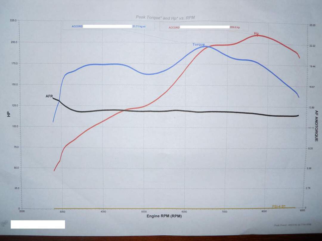

Below attached my dyno for my K20A ? Sifu - sifu, may be you all can comment about the power output ? ( i saw a dropped of output at around 5000-6000rpm ? Anything can correct it ? )
whp 209
torque 21
Dyno RON95
Car age 04/10
Next step you all suggest ?

how much are you willing to spend ? thats the ultimate question.
You have not done headers/extractors which will gain at least about 10whp to 15whp depending on which brand u go for.

by the way, is it normal for the 5000-6000rpm power dropped?
cant feel it when driving..
planned to do de- cat first... this weekend... see how is the high end power gain

power drop is normal, that just means your car is not making any more power in that power band/rev range. A camshaft would help that problem, it broadens your power band. Depending which cams you get, u can improve your torque or top end power, or both.
If i were you, get a branded headers/extractors, delete your cats, get some cams ( you have to do your research ) and then a retune. This should squeeze out another 30whp i would imagine.
But if you're willing to spend 10k, i would suggest turbo charging it :) Vtec to me is just all the LAG and none of the Turbo boost. To solve this problem, turbo charging is your best friend. Just imagine Vtec kicking in + Boost kicking in.
10k should get you a decent turbo kit. Turbo charging an N/A is my ultimate recommendation, you can shut your friends up with whatever bullshit they say.

Most stock K20A with stock header does 180 ~ 190 whp
Only for FD2R they does 190 ~ 200 whp
Your result look too good to be true for a almost stock set up with Ron 95
K20A stock dyno sheet for your reference
Stock CL7R @ 185 whp on a Dyno Dynamic
Vtec Engage @ 5800rpm
Rev Cut @ 8600rpm
Stock DC5R @ 187 whp on a Dynojet
Vtec Engage @ 6200rpm
Rev Cut @ 8600rpm

dfx16 - the above graph without Hondata k100 right?
My K20 previously also 180+ whp stock ( CL7R ) - without hondata.
but after hondata and open pod filter and single exhaust - then 209whp
My friend FD2R even higher output without header and extractor
During weekend...i read thru so much.. even read about the Hondata tuning program online... it is very very complicated...trying to figure out.. ( Lucky my K100 cant tune...if not...i think my car spoiled already by me self tuning..haha )

BTW what Dyno machine u run with?
Dyno Dynamic and Dynojet are known to loss between 15 ~ 20% drivetrain
If u prefer high rev u shouldnt lower your Vtec engage point
Your chart is somewhere 4600rpm engage and ease off somewhere 7600rpm
If u had noticed both CL7R and DC5R fine tune flat spot and left VTC untouch

i dont know what dyno they using...on the graph it has " correction method : JIS " and some " PSI-4 B1 "
i didnt follow the tuner go for dyno.. it is the 2 wheel dyno at Torque racing JB ... i think

The dyno results in Torque Racing is higher than other places. In JB, the dyno results always tend to be higher than KL. I don't blame if others may think that your dyno results are high.

ddv_nk12:
haha...feel weird too...cant be so much different in N/A without much modification
