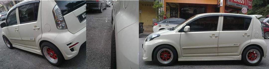

last week change my rim n tire stock myvi 14" to 15"
change 195/55/15 and + gab sport spring + stock absorber
and rim and tyre was terkeluar about 1"
my problem is..... rear tyre was hit my fender.....
my friend suggest me to change to adjustable.. is that true ? or just change the new absorber?
my budget around Rm1-Rm1.3k max......
see at mudah mines adjustable rm 500++ ok or not this brand?

u hv 2 choices :
1. get a stiffer suspension (this will make ur @$$ hurt)
2. knock ur fender to prevent ur tyre hitting it
gudluck :burnout:

thk D7zul & DanzEterna....
so sayang nak ketuk2 fender or roll it.... if my car is toyota dx i dah roll....
i prefer to get set of adjustables... but with my budjet 1.3k max......
if look at price maybe i get mines adjustable... at mudah rm575 but can this adjustable solve my problem

adjustables will definately solve your problems, but if u want your fenders closer to your wheels,
u gotta get with soft hard function, if not, hi-low will do.

ok.... danz..... maybe for begging go for hi-low but if my budget can get hi-low soft -hard i go for it... can u suggest me.. with my budget 1.3k what brand do u prefer?

if u get gab ha series hilo function also ok.
already checked hilo soft hard above your budget.......
other brands, hwl, hotbits....if not have to go for mines....

go for this also ok edi...
keep your balance RM for something else

I think roll fender may not work as TS mention rim/tyres 1" out from wheel arch.
If stiffer suspension, heavy load might still hit fender, but light load time, then okay, but cannot lower....

Rims offset very far out. What offset may I ask?
Tyre see can sell to friend? Trade sure rugi already....

It looks like my KE70 tyres.. Protrude out like that
Front i knock d fenders
Back i knock d fenders n change to stiffer spring
Up2u which route u wanna take :wink:
