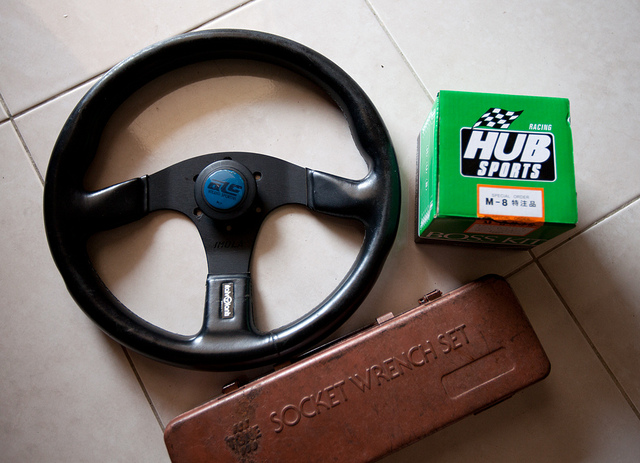

What everyone these days do is buy a cheap steering wheel (or half cut one) off your friendly local auction site or off a friend and that's exactly what I did for RM150. The HKB brand steering adaptor or bosskit is brand new off the shelf for RM25. All I needed was my trusty tool box and I got to work.
