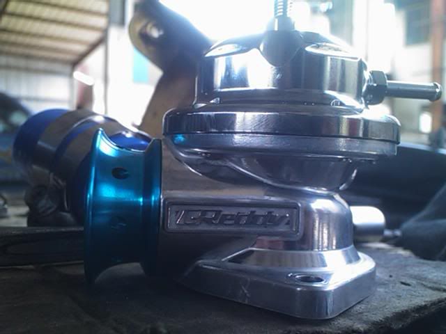

BOV actually helps to relieve excess boost pressure when lift-off throttle (whether you are changing gear or going to slow down) so your turbo won't rosak so fast because of the backflow of the charged air into the turbo again. Wastegate is a device to ensure that your boost holds steady at the pre-set level to prevent sudden spike in boost pressure. sudden spike in boost can be very damaging to your engine.
For a much much clearer picture and better understanding, click HERE. Your answer lies in part 3 but there's no harm reading through it all. Its very good stuff when i first learned about how the different parts of cars work. Explore the whole section and you'll find info about engines, gears, camshafts, brakes, suspension, everything that you need to know about cars.

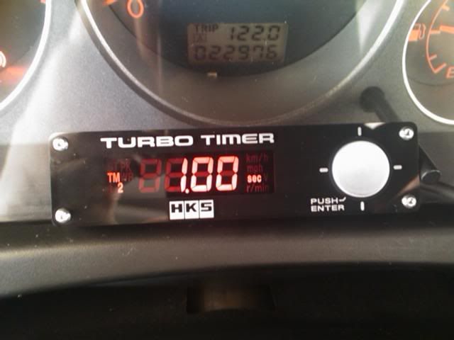

HKS Type 0 Turbo Timer..it's a bit pricey but all the basic functions suit well with my ride & never gave me any probs so far..looks sleek too..and I don't prefer Type 1 bcoz to me it has a lot of unnecessary & redundant functions..
GReddy BOV Type RS since mine is stock boost & hp..at 1st wanna opt for HKS SSQV but some friends told me that they experienced similar probs such as spring loosen up easily etc..this Type RS is not suitable if u plan to tune up to more than 500hp..u might wanna go for Type R..

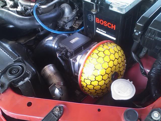

HKS Racing Suction Kit Reloaded..looks cool to me & the sound it yields can easily make me cum haahah :biggrin: but unlike K&N u can't clean the mushroom and re-use it back..
next pit stop..racing clutch and ECU :biggrin: hope I've racun u enough with these pics..happy modding..
