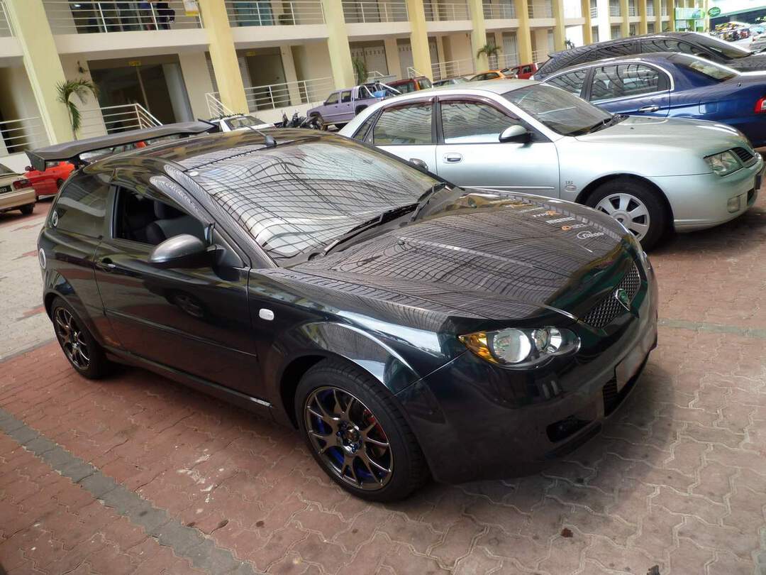

I mean 2-3 fingers between fender and tyre. My ride height is 3 fingers(between fender and tyre) with 12.5cm between my front bumper and ground. Almost 4 fingers when I clear The Curve basement parking. *haha* I cant imaging how can I clear other shopping mall basement parking. Sucks....
Just measured my car. Now ground clearance from front bumper is 1about 14.5cm.... if i lower 4 cm that means will have 10cm+- of ground clearance left... behind i'm not afraid.... i'm gonna lower behind more. Maybe 5cm... coz CPS back suspension is blardy high...... Only thing is have to make sure the tyre dun grind the fender.

Btw, nice carbon wing you got there on your neo. :top:
