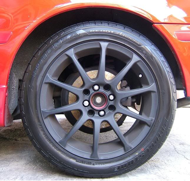

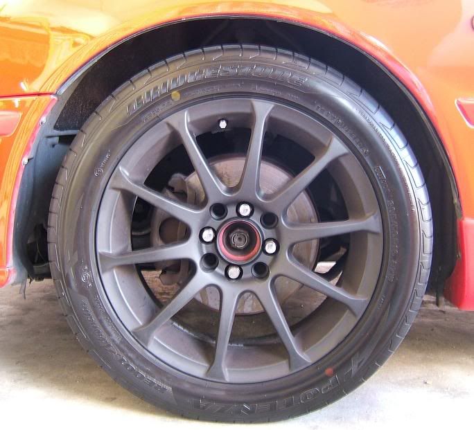

I have a question about gen2 teg braking system and need some suggestion...
Below is my wheel photo,
(Front wheel with 205/50/16)
(Rear wheel with 205/50/16)
When i drive over than 90km/H,
I feel my car braking system hard to slow down the speed as a moment,
Need to take some time(so dangerous)...
May i ask,
Gen2 teg owner have a same problem as me?
How you all people solve it?
Change bigger rotor and caliper?
Or use 15 inch rim can solve it?
Because i plan to change my rim and n tayar saiz to 195/55/15...

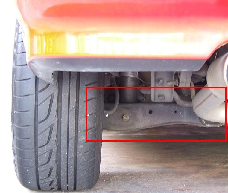

One more thing,
My teg rear LCA setting is horizontal 90 degree for this moment,
It's posible to lower my car height anymore?
Or horizontal 90 degree more suitable for handling?
Thanks a lot

Hi,everyone...
May i ask,
One more thing,
Thanks a lot
For the DA6 if u lower too much ur centre bullet will scrape the speed bumps so better not too...Also the more u lower the more ur tires will have uneven wear and tear.....but yes u can lower but with all the conditions above
As for your brakes have u checked ur disc? is it warped? or already time for a change? U can try the Brembo Star disc....
Also for the brake pads...try EBC for better grip....
U can also upgrade your brake hose to the steel braided type
As for changing you can mod the Prelude BB1 one in...much larger disc but the issue is its heavier...so unless u have a powerful engine (like someone we know in Teggerz) it can be a problem i feel....
About car height lower,
Thanks for your reply and suggestion...
May be i just lower 5mm and go to shop to check my camber(now my camber is below 2 degree)....
Because i try to lower 10mm before,
My camber is around 2.5-2.7(front),2.0-2.5(rear),
Too much for me......

Am not sure wat cambers are mine lar....but mine not too low....
Warped means the brake disc "bengkok" not smooth anymore.... when u brake does it have any sound? if yes then its warped......
U changed the brake pump but did u change the brake servo? I suggest u change to the type R double layer one....it did make a lot of difference for me.....but again if u really want more porwerful braking u should also consider the Prelude BB1 disc and caliper....much larger and better grip.....
MK pads am not sure....usually I recommend EBC....or if u use the Prelude disc and calipers u can try Endless.....
