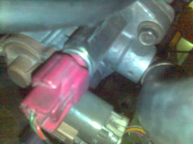

bro did u dismantle the iavc yourself? would like to service -tps,iavc & maf myself also. Did u use maf cleaner for the 3 parts or throttle body cleaner?
I bought Throttle Body cleaner and bring it to my mechanic to clean TB, IACV and MAF. After back home, I dismantle again IACV to unscrew the the internal part and clean again (mechanic just clean from outside after dismantle).
Don't think need to clean TPS. and beware of rpm upside down if you dismantle TPS. You need scanner to make sure it is at the right position when fixing back.
don't think need to clean tps. And beware of rpm upside down if you dismantle tps. You need scanner to make sure it is at the right position when fixing back.
thanks for the info bro. By the way how's your car now?smooth running , no more stalling ?
i did clean dat ting b4...but it oni helps minimise da "near engine stalling" problem.
i got engine stalling problem once da engine is running under normal temputure...da enigne seems to stall when da gas pedal is release.
thanks for da pics :)
