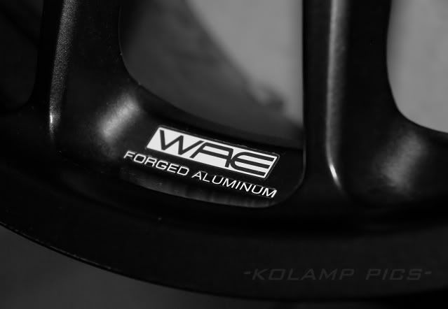

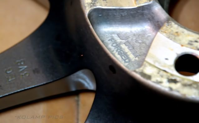

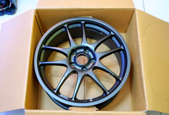

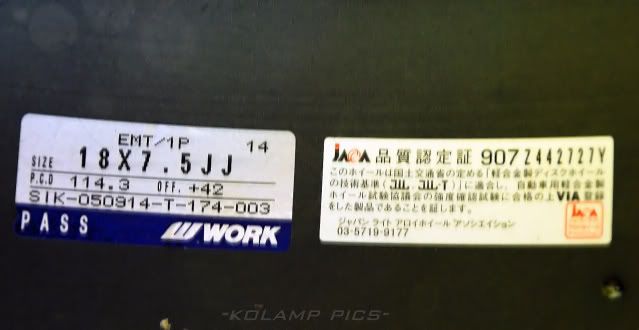

I found there's few version of WORK Emotion Kai CR depend whether its a forged or cast wheel & both is ORIGINAL...maybe the tire shop never saw the forged version one dats y he mistakenly accused its fake...forged kai CR very rare on market & only got 5 lugs while cast alloy kai CR got 10 lugs....Some example bout forged kai CR
Should have this sticker
And this word at d back
More details bout the forged kai:
