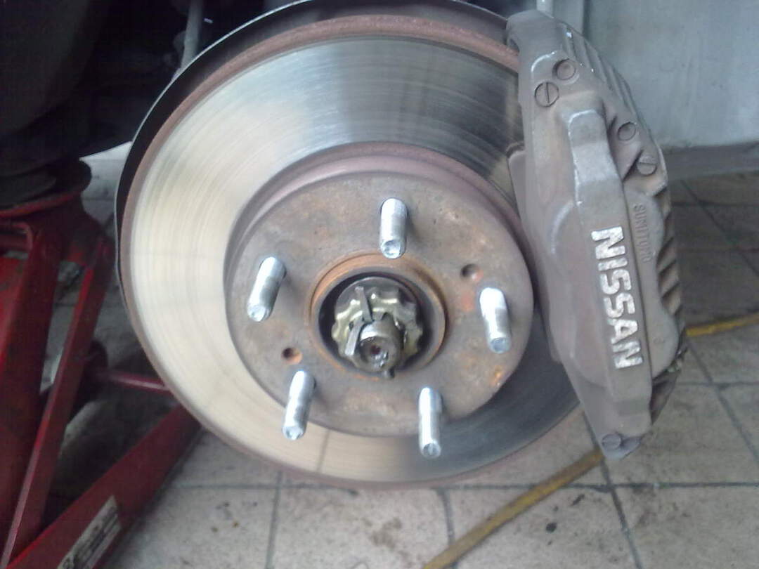

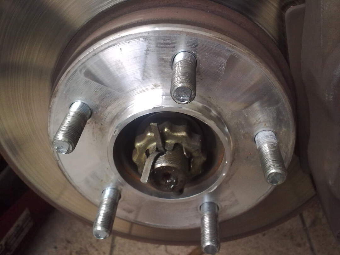

Try to use the S14 or S15 twin pot, but you may need a 9mm spacer to give some buffer. Attach is what I did.

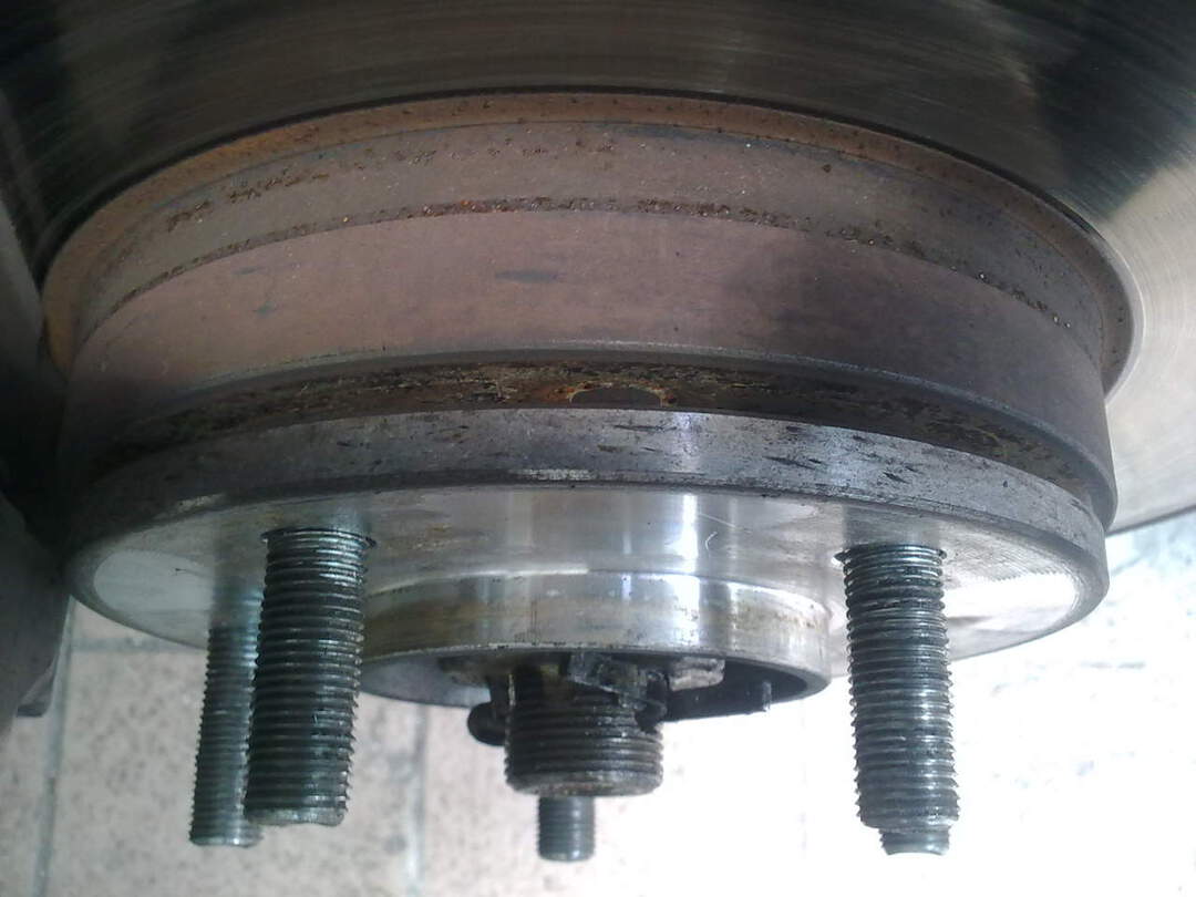

Sorry bro, 4got liao, 1 year liao. I just calculate how much space I need to free out from the brake caliper, and change all the screw to longer 1cm, finally told the tire shop to custom make the spacer with center hold than settled, lucky the rim is giving a lot of freedom.
btw it will change the car handling in corner if you just put in the front spacer.
Silvia(S13~S15) and Skyline GTS use the same brake caliper, so as long as this type plug and play. Original brake caliper in high speed u knw it can stop but take sometime, but this one u will feel really can stop faster but provided your tire can handle it or not.
