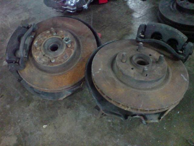

Taken out from galant 2.0 V6 twin turbo front twin port caliper n rotor disc only RM400

can it be fit into a 15" rim ?
need to do any skimming?

i"m not sure it can be fit to 15" sorry wo..

can the VR4 disc & caliper fit into a waja 15"
nop. it cant be use but Waja can use the FTO caliper and disc.

I think waja can use the vr4 or v6tt disc n caliper, my friend done it last year just to modified the brake hose screw.

He is using 17" rims, acording to him, 16" also can fit n using the original brake pump so far so good. RM350 only the brake kit. installation he did not more than RM50 +just a minor mod.
yeah, anything twin pot at least need 16" rims. i dun think it's just to mod the the brake hose screw so easy lor. i asked whn i wanna did mine that time, they said abit complicated job lor. i dunno la.

disc, caliper n knuckle RM400 pcd114.3
i don't get it why can't the brakes fit in a 15" rim ?. the standard specs from a galant vr4 are using 15" . the problem is more towards your rim's offset not the rim diameter .
fto , vr4 240 , pajero v6 , evo 1-3 , naza ria all using the same twin pot brakes , only the hub is different , 5 lug & 4 lug thats all , others are just the same . if it has 5 lugs then easy la just take out the disc and drill the disc to 4 hole and then use back your original hub then kautim . what is so complicated ? :rolleyes:
