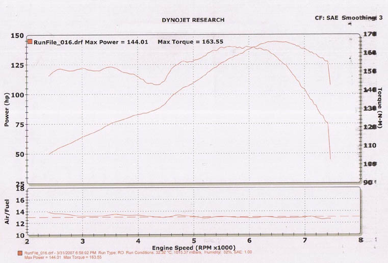

This is my previous dyno chart.
As per mentioned,
Run 1 is with stock ecu
Run 18 is e-manage with adj cam pulley.
Btw, observed torque dip at 4300rpm and still unable to recover by e-manage and adj cam pulley.
Suspected:
- is nature of 272 cam
- 4-1 extractor
Any input?

Saw this from NS performance ..quit similar with my mod.
Also, notice that also have torque dip at around 4300 rpm..seem like is the nature of the cam.
