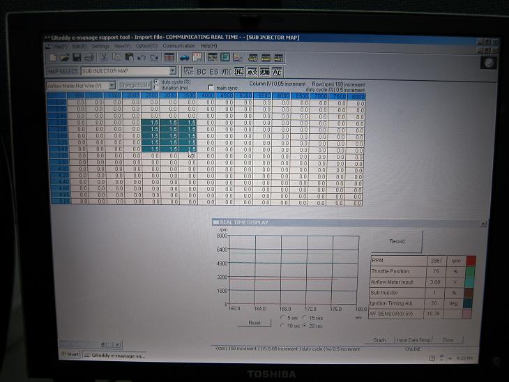

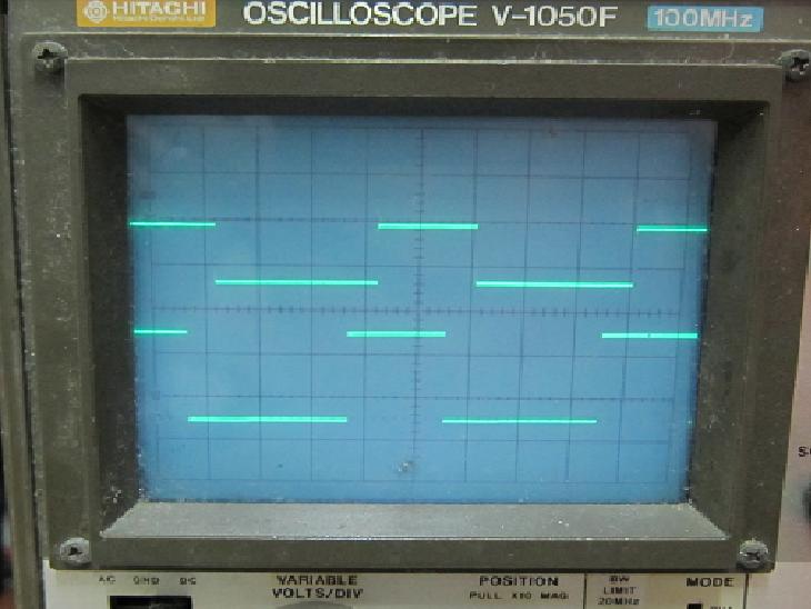

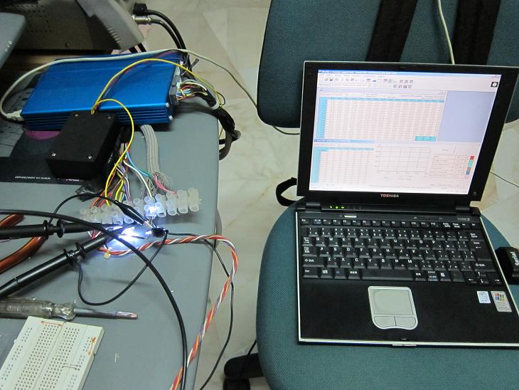

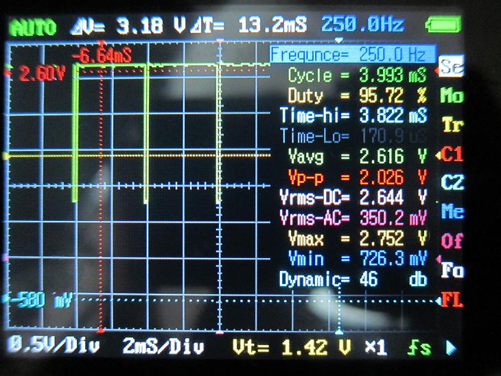

Added some pictures. Same picture I uploaded to emanage yahoogroups. This was the successful testing on bench. Set up for an engine with a distributor. Development continues and testing on a vehicle soon.
Picture ntck is the normal emanage tuning screen.
Picture osc is the oscilloscope reading of the change in ignition timing.
Picture tst is my messy test bench.
Picture tstosc is the screenshot of the dwell time I had set at 3.8ms at7500rpm.
