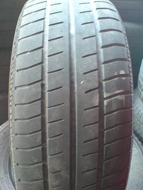

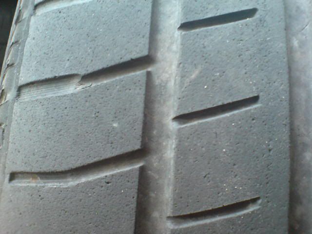

if u googling aroun u'll find tyre grooving device..
pretty much like power hand drill/grinder but specific to re-cut tyre thread.....
normal tyre already got plenty of flower how to cut paste again to become semis....
but if u got slick tyre want to use on slippery surface like normal road or damp tarmac u can use the tool to cut thread pattern and become semi slicks.... :adore:
those lorry tyre was "re-thread" by "celup" the bald tyre with new rubber surface.....
Just wondering what they use to cut/regroove the bald tyres?
Can cut semi slick design on normal tyres ah? Haha
Similar to this. Electric operated to heat the blade to cut as tyre rubber is pretty tough.
Yes can cut the grooves or design you want, but semi to normal, not the other way....

Yes, most are re-thread where they cook another layer onto the tyre carcass, but there are certain truck tyres that can be re-grooved and it is mentioned on the sidewall...
