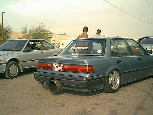

Waaaaah!!! Dunno about your project...but mine had TURBO sounding motor, very heavy consumption and failed exhaust emmission test repeatedly... :laugh:
Still...very strong chasis, so good foundation to plan mods on... :laugh:
WAAAAAAH!!! SURE NO PROBLEM WITH EXHAUST RESTRICTION ONE!!!... :laugh:
