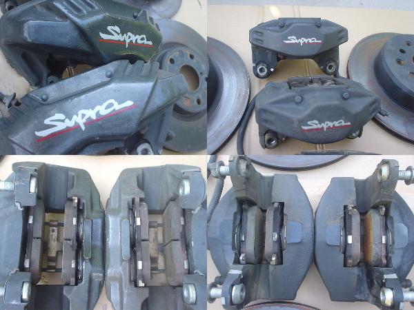

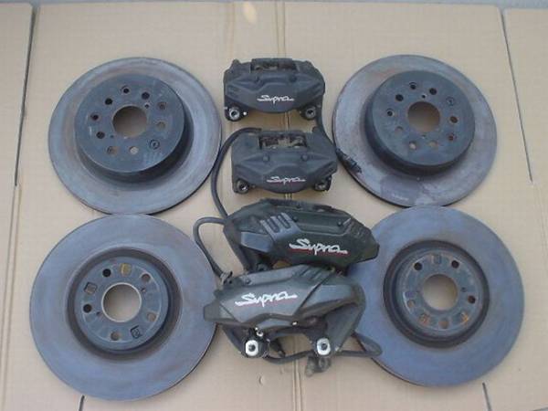

Dear all experience altezza owners,
just want to ask newbie question regarding the below brakes from Supra
(click image to enlarge)
https://www.zerotohundred.com/forums/attachments/292937.vB
https://www.zerotohundred.com/forums/attachments/292938.vB
1. is it 4-pot front ?
2. IF IT IS-4 pot front, can it clear stock 17" rim of altezza ?
3. need to mod mounting bracket ? or straight plug & play ?
thanks in advance.

1. yes 4 pot..
2. dun think can clear stock 17" rims
3. yes, need to mod..
For the front rim, the offset must be less then 35 mm for the caliper clearance I remember if I m not mistaken that our stock rim offset is 50mm, for the rear is not a problem. Yes , u need to modd a bit at the caliper

changed my front brakes recently to TRD 4 pot with TRD brake hoses.(similar dimension to Supra's 4 pot calipers, only that the discs are ventilated).
the only thing is the calipers need to be modified to fit into our Altezzas (bracket, bla bla...) the cost is around RM500-600++. U can ask Trial to quote.
U can ask Bl@cK-TeZZ@ as well. Mine is exactly the same as his. :driver:
1 more thing. It's really hard to find 17" rims that can fit into these 4pot brakes. U might have to change to 18".

Yes bro steven is correct.
Our altezza/aristo/chaser/supra all share the same front n rear wheel housing, so the supra front n back calipers should fit nicely. probably a little mod is needed thats all.
Front.
Supra 4 pot can fit into the stock/oem 17" rims. but stock rims offset is +50, so u will need at least a 15mm spacer to clear the supra caliper.
Supra disc rotor is 323mm size, this will clear all 17" rims.
Probably need to mod the bracket a bit. Mine is minimally modded at vision bangsar. bought the front set brand new for rm3000 few years back.
rm3000
new 4 pot calipers
new disc rotors 323 mm vision
free toms brake pads. brake lines i reuse my own
i think now more expensive lo.
Rear.
rear supra will clear our stock rims with no problems at all. Disc size n 2 pot calipers will not be a problem. no need spacer. bracket need to mod? this i dunno
only problem is finding the new disc rotors for the supra rear calipers. These are different from our stock altezza rear rotors. They are ventilated. can find? hahahahah.

i'm using 17" (offset +40), BUT not stock rim, the reason i mentioned stock rim is for my reference and newbie thoughts that if those calipers can clear stock 17" then it will potentially clear my aftermarket 17".

thanks for the tips, i'm now thinking the ways to 'avoid' changing to 18".
spacer..spacer..spacer...
