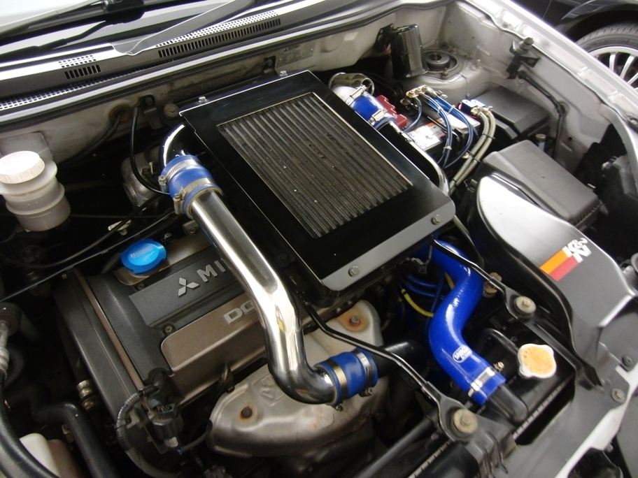

This is stock setup. (my old setup)

When I look properly at yr picture, I noticed:
- It's aftermarket manifold/banana
- Has external wastegate
- Uses 'tulang ikan' boost controller
- Aluminium radiator
- Has adjustable fuel regulator
Most probably it already has TD05 too. The previous owner has already done some mods to it. Maybe just the intercooler left to be done, then yours is quite good for 240whp.
TMIC is really bad for hot days traffic jam situation. Yes, setting boost too high will result in knocking.
my friend had declined that the changed the td04 yet, but all the above mention mod are correct. I am going to the workshop tomorrow. will take extra picture to confirm.

Well it's possible still td04 if he used a different outlet pipe for his turbo.

guys, i can confirm that that is still stock TD04 as the intake hose is still original 2 piece hose.. once change to TD05 only need 90deg elbow samco hose connect to turbo inlet. since he already uses custom manifold + wastegate, the old owner turn the turbo downward so can easily make pipes for FMIC i guess..
I agree very much with your observation. I've forgotten about the external wastegate. the intercooler pipe must make way for the wastegate hence diverting to a different direction. GOOD OBSERVATION!!!
