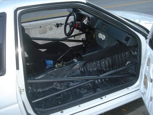

[font=Verdana, Arial, Helvetica][font=Verdana, Arial, Helvetica]FRONT Suspension:
T3 coilovers (tokico HTS)
8kg spring
Tein Pillow Ball Camber Plate
T3 Negative Camber Roll center Adjusters
Ueo Style Pillow Ball Tension Rod
Ueo style Lower control arm
REAR Suspenion:
T3 Coilovers (tokico HTS)
6kg spring
Cusco Upper Formula Links
Cusco Lower Formula Links
Cusco Lateral Rod
Brakes:
FRONT :
T3 300mm Big brake kit
Willwood calipers and pads, Precision brake co. Rotors Stainless lines
Rear:
Brembo Cross Drilled Rotor Cryo Treaded by Porterfiled Enterprises Stainless Lines Porterfiled R-4 Full Race Compound Pads
Steering:
True Manuel rack
True Manuel column
Power knuckles
Drivetrain:
Transmission: 2002 6-speed Honda S2000
Custom Propeller Shaft
Cusco RS 2 Way LSD

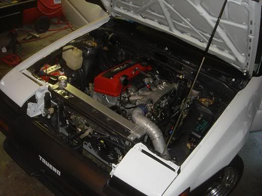

Motor/Power:
2002 Honda AP1 (S2000)
AEM Engine Management system
HKS Exhaust
Custom Intake By Evolution Motor sports
Custom Large Volume Aluminum Radiator , Two 10" pusher fans w/Thermostat starter
Instrumentation:
2002 Honda S2000 Digital Gauge Cluster
Greddy 60mm oil temp
Greddy 60mm water temp
Body:
J-Blood Wide Front Fenders
J-Blood FRP Doors
J-Blood FRP rear Over Fenders
J-Blood FRP hatch
J-Blood C/F Drop Vent Hood
J-Blood Rear Wing
Toyota sprinter Tails
Toyota Kouki Bumpers
Toyota Zenki Front Lip

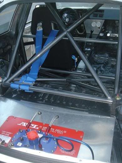

Fuel System:
ATL 8gal Racing Cell
ATL "Black Box" Surge Tank
Walbro fuel pump
Custom Install By Full Function

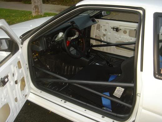

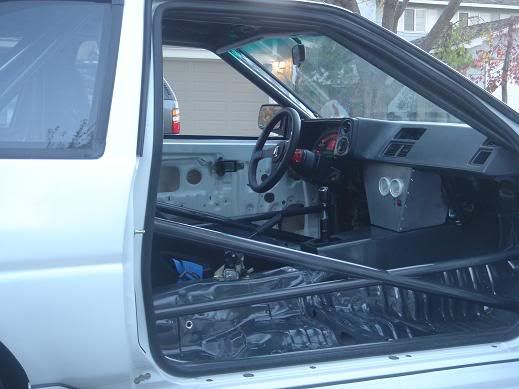

Chassis / Reinforcement:
Full Function 8 point cage
Stitched Welded Seams
Additional Spot Welds on Door Frame and Rear Quarter Window Frames
Wheels/ Tires:
15" Work equip 01
yokohama es100
Interior:
Sparco sprint seat
T3 75mm hub extender
Nardi 350mm steering wheel
