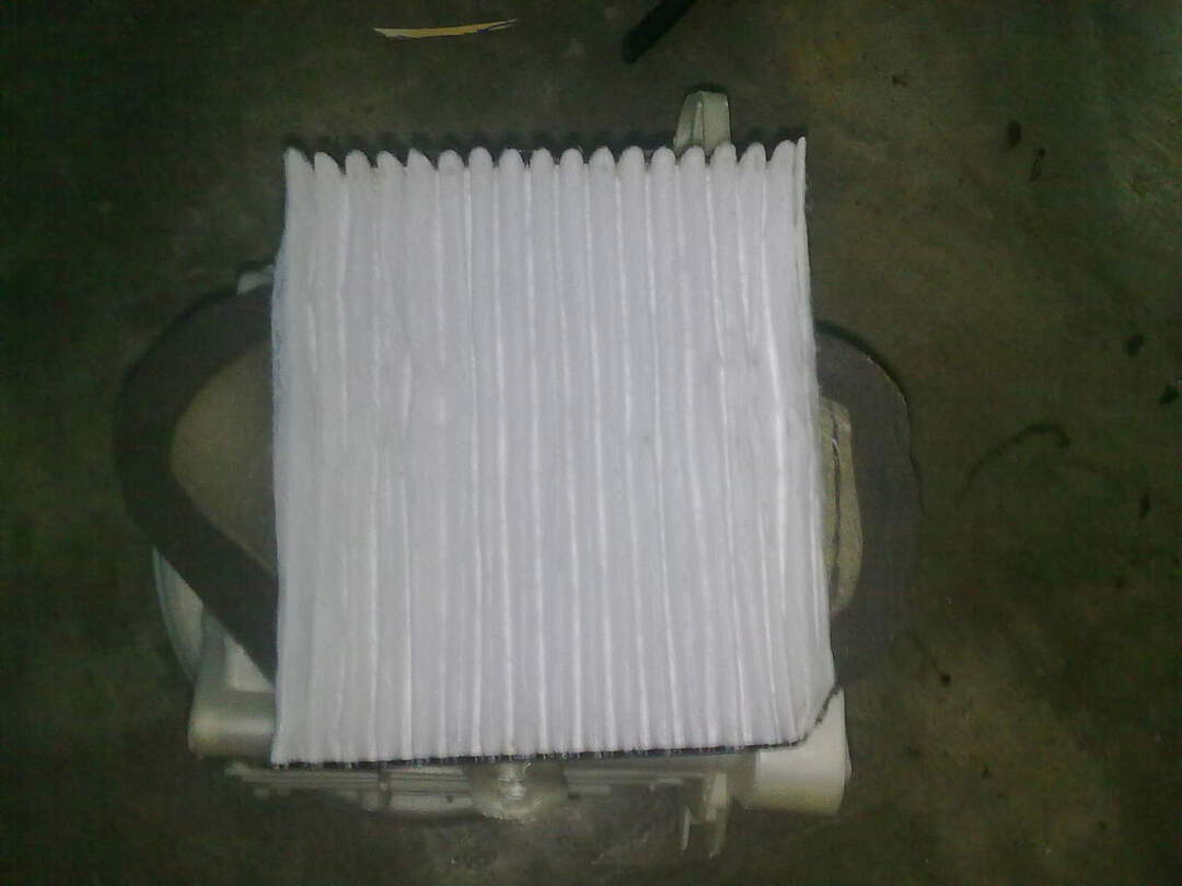

Hi All,
Here is wat I did for the cabin filter modification. I jz cut out d size n fit on top of the blower as attach in the photo's
