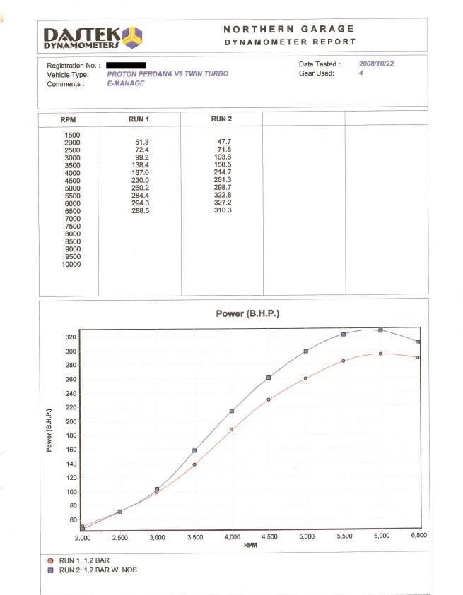

yes..agreed with bro danzEterna..just put in e-manage, walbro fuel pump n up boost..easily can get 270hp...
p/s: my fren just put in e-manage, boost 1.2 bar with NOS kit..327hp achieve already...
as a prove..refer to dyno graph..without NOS and with NOS...

Bro Toprpm, block still standard or used differnet model?
