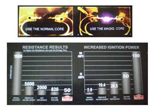

they claimed that thier product fall under 1.2 Ohms/mm (how to convert to kilo ohm ???)
later i found out another product on the market, Pro Rallye similar to Nology...a bit curious cuz done a little research but, couldn't find any in the net...
have any one used this product before ???
how was it ?
