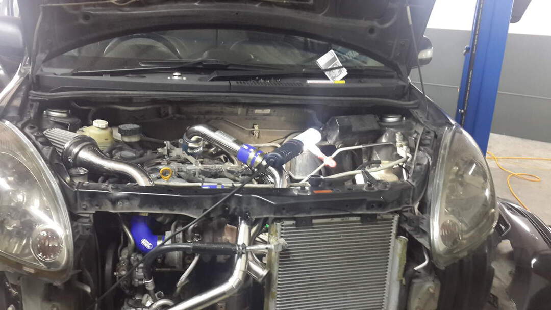

Still in progress
Shield your air filter bro. Custom made the cover to prevent it sucking hot air from the engine bay.
Take time doing it. Done properly, worth all the time you take.
Driving a turbo car which sucks in hot air is very annoying, irritating, stressful, uneventful, you name it.

Actually for me is not too bad, still got intercooler. NA will be worse....

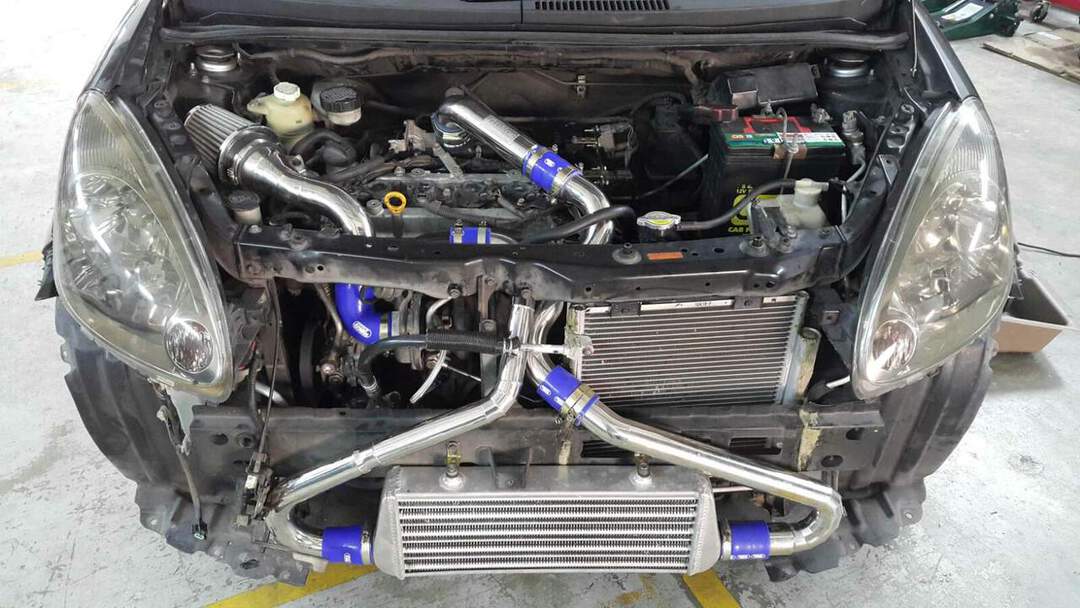

Still in progress
if me...i'll put the air filter direct infront at the bumper (but not too low...just about the same height of the turbo snail)
then the intercooler piping route can use the empty location of stock air filter....better heat management
