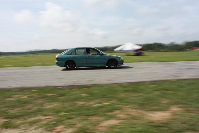

This is what it used to look like. Simple P, R, N, D, 2 and L. D and 2 being used the most, I had thoroughly abused this indestructible gearbox sometimes hitting the rev limiter whenever the need arised (you never really need to hit the limiter, it just sounds cool. Sorta). Back then, my car was named “Sharon” because that was the first name that came to mind when I first bought her. Reliable, sexy and completely manageable.

Now that she’s got a new set of gears, ‘Sharon’ seemed an inappropriate name. No longer was she easy to handle where you just give her a little nudge and she’ll waft off into the direction you point her to. She now had to be coaxed with a clutch and put her in the wrong gear, she’ll scream at you until you re-clutch and prod her into the appropriate gear.
Meet Alice.
Alice on the other hand is the real man’s car. 3-pedals and you always have the last say on whether she screams ecstatically “REV ME HARDERRRR, MORE MORE MORE!” or gives off a slow and mild cough,  sputtering off in the most unassuming way.
I know modern cars these days have dual clutches that shift in nanoseconds or superb DSG gearboxes that change gears so fast and so seamlessly you hardly notice the change, but ask any hardcore driver… Manuals rule.
I’ve already done a dyno when my car was still Sharon. Soon I’ll re-dyno Alice once I sort out the ignition timing and cam angle to squeeze out the maximum amount of orgasmic pleasure I can get from her.
