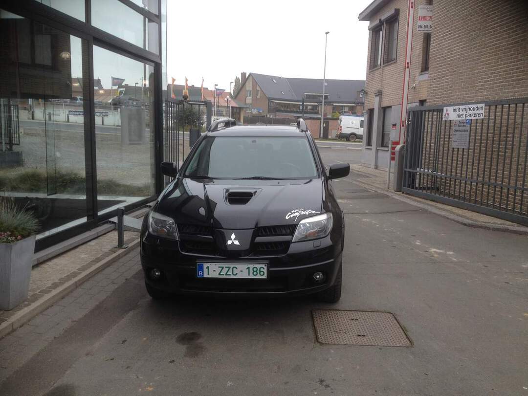

hey guys,
i got an outlander turbo which resembles at the airtrek (airtrek got more power).
i've got an issue where one of my injectors is leaking fuel which is giving me fault code on misfire on cyl 2.
Swapped him to cyl 4 , and yes got the fault code now on the 4th cyl.
in belgium there is currently no stock of original injector , mitsubishi reference is MD336460.
does the airtrek use the same injectors? and if so, what are you guys using as aftermarket replacement injectors?
cant put my car 2 months aside because of that injector.
