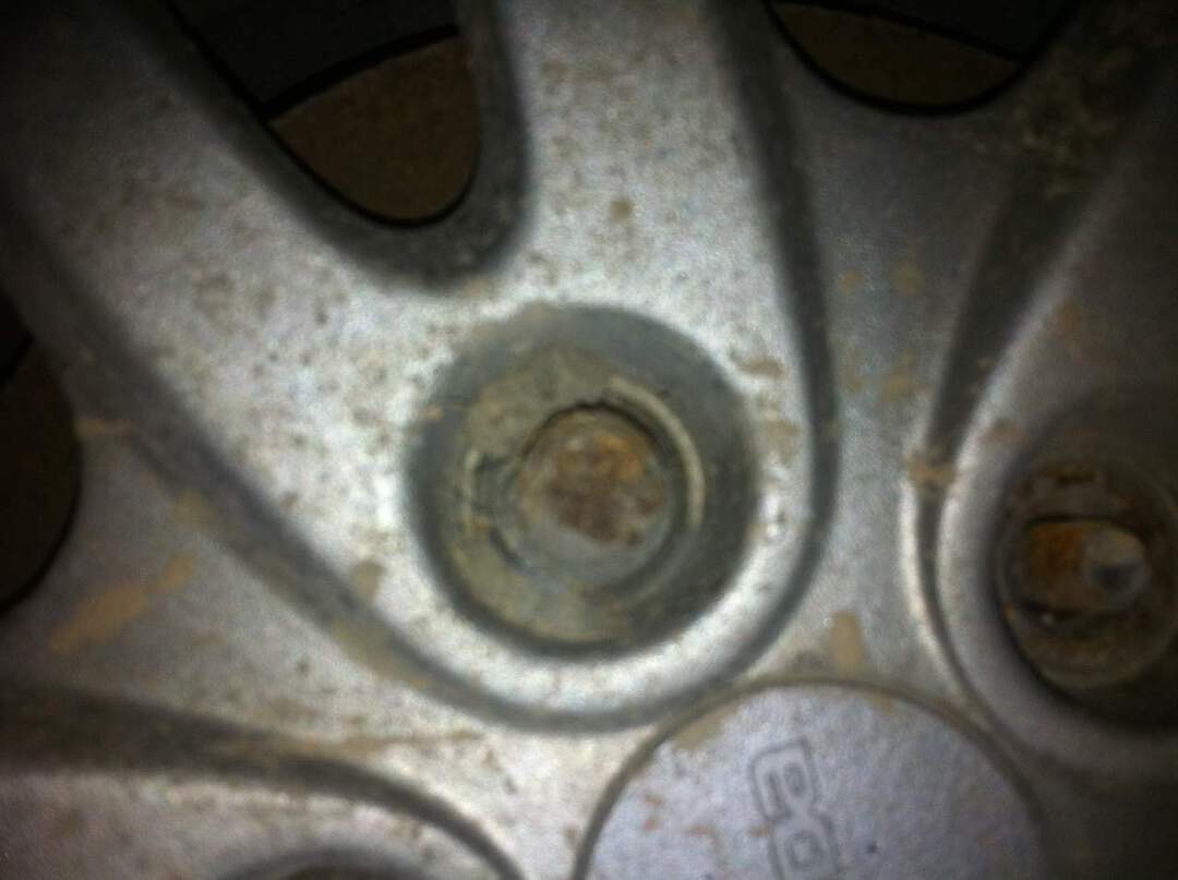

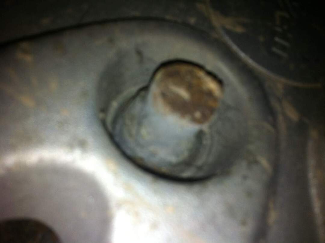

Dear Guys
Both front wheel nut of my halfcut is special nut but unfortunately i dont have the special tool to unlock it. Anyone any idea what available tool on the market to unlock the nut?:confused:
Any ideas are most welcome. Thanks for viewing my thread.

welding it with a steel bar.. then u can open it...

i had that problem once. the inner of the lock nut went from hexagon to round shape.
get urself a bolt (size 9 or 11 if im not wrong) and weld it to the lock nut and im sure u can open it.

well i guess i have to find welding machine and weld lock nut and hope fully can open it. need to figure out the weld machine and bring it to my house.

just go to any tyre shop.. usually they have dozens of wheel nut opener...
aivenrolx
Jul 30, 2008
250
7
hv a special tool juz for loose nut~
ask any worksop hv ornot..
if nt mistaken tat tool price around 100 to 300...
Nov 18, 2007
3
1,501
once my friend had his lock nut opened by using a special tool from the tyre shop.
it costs him MYR 10.00 for total 4 tyres opened.
the tool is more like a engine oil filter opener, which is adjustable.
once locked, then can open the lock nuts in a snap!
