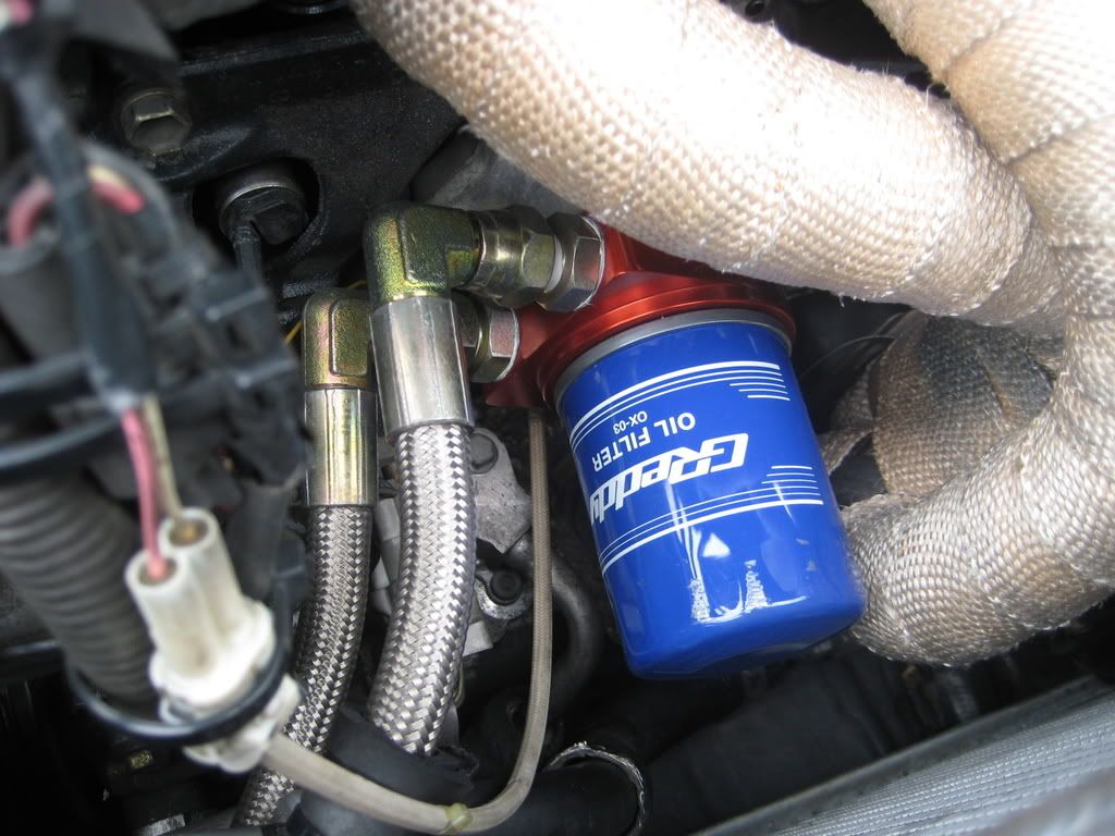

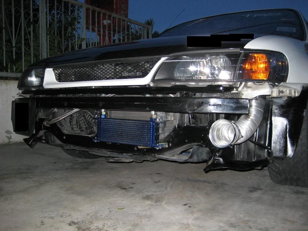

i've been using it for 2 yrs now, quite a big ass cooler...positioned to juz behind the grill and the filter beside the radiator. yeap..oil pressure will drop, but no significant power drop. if you install it, better install along oil pressure and oil temp meter for you to monitor it, and if you not sure if the pressure is acceptable, juz post it up here for feedback.
big ass cooler:biggrin:like chu one ah? with that big cooler, maximum can go ho many bar?
yup agreed with wat u said, oil press and oil temp meter is important after installed oil cooler.

chu's one if i not mistaken was 5 very long rows, mine is 13 rows although not as long. so it's juz the dimension diff. max i can only do 6bar..:(
