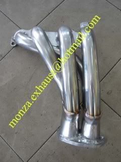

Hi bro, im not sure if my opinion is expert or not, but i'll try.
Refer to this MYVI 4-2-1 (S.Steel):
U can see that 4-1,2-3 design is most common. Manifold pipes sized 1.6". So, extractor is not really the root cause of power loss. Well, I will not say power loss the right word, as i can see that your setup is okay BUT power will be much felt at higher rpm about 5k-6krpm (FC is affected :) ). HKS SUPER DRAGER Semi S-FLOW?? Provide me a picture. Semi S-Flow like MUGEN TWIN LOOP style? If yes, then fully understand that you wanted back your pick up power. AUTO tranny has problem with keeping the right pressure.
First, Get a good S-FLOW muffler. AFAIK, 3 pipes designed inside of the SFLOW is the best to keep delta-pressure (pick up power retained). Another point i felt that needs to be improved is the center box. Is that straight flow? Any filters? U need filter to keep pressure for pick up. Piping size, if 1.7" diameter, alright for low end torque purpose..i would say JUST NICE!

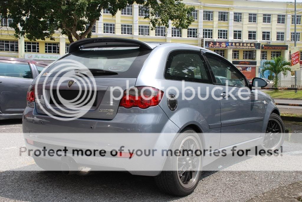

http://203.223.133.166/images/74/7493714590.jpg
this is the exhaust i'm using now
any comment?
inside not straight flow n got sth "block" in the center, so i think this is S flow rite?

Not S-Flow. AFAIK, HKS SUPER DRAGER isn't s-flow at all. The design goes like this becoz it is meant to create bassy sound. Besides, it is too big for your car. What is the inlet size? 2.5"? I saw the outlet of the muffler is roughly 2.5" (i dont mean the tailpipe). So, basically your car losing pressure. Time for you to get a proper s-flow model muffler bro and center box (make sure u have extra filter inside). That's my 2 cents.

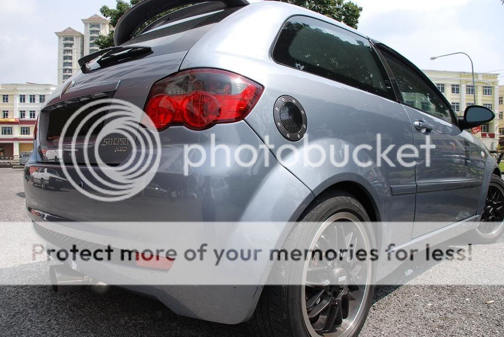

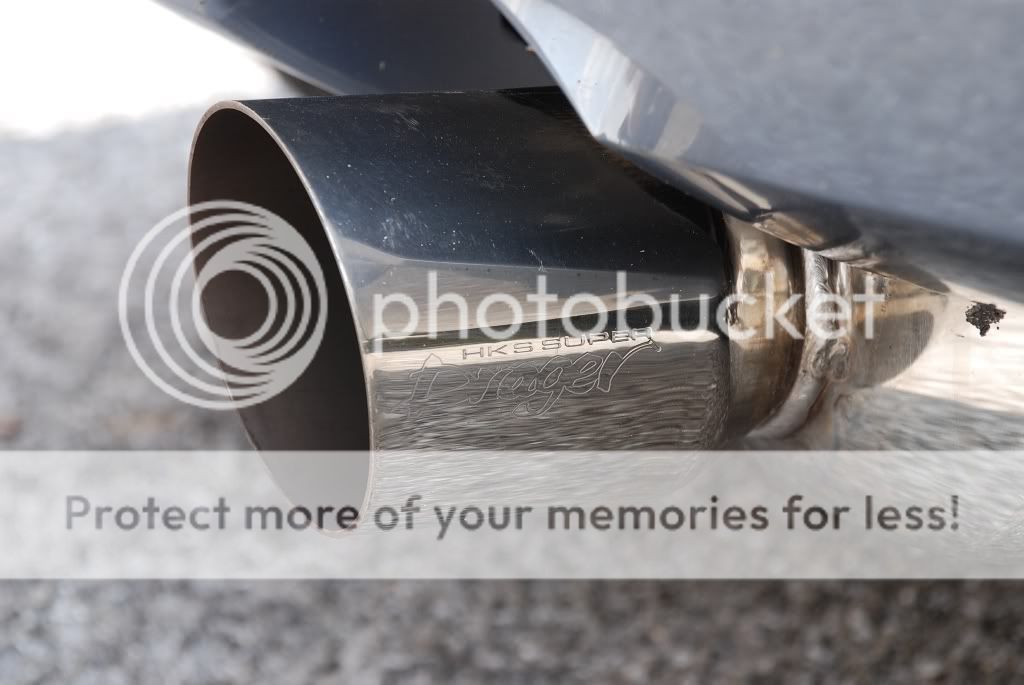

these r my pics for exhaust
inlet 2" outlet 4"
Bump: these r my pics for exhaust
inlet 2" outlet 4"

Bro, where u bought it? Is that original? Sorry becoz' the last picture's welding isn't Ti-G coz' as i know japanese muffler's welding isn't like that. Nvm bro, i suggest you come my shop and let me see clearer when you free. Anytime. Call me. K.Weng 0125629713
Bump: Bro, where u bought it? Is that original? Sorry becoz' the last picture's welding isn't Ti-G coz' as i know japanese muffler's welding isn't like that. Nvm bro, i suggest you come my shop and let me see clearer when you free. Anytime. Call me. K.Weng 0125629713
True true....the welding on that one is no where near the Japs standard welding..... I hope you did not get conned.
