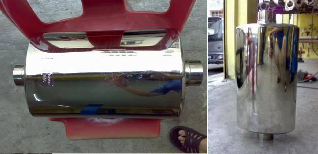

Well bro, i assume u driving a manual EG with b18c engine. 2.3" piping and 2 bullets will be nice setup. But, if it is too loud, u can take out one bullet and replace it with a flat midbox. Flat midbox usually reduce more noise. I attach a pic for u to see here.
