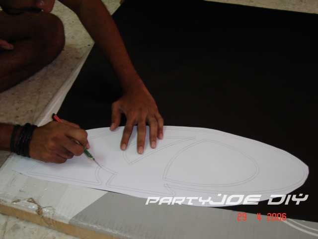

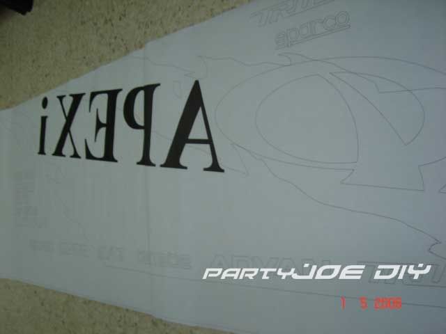

started wit the design process
printed design layout
confirming size n adjustments
spray mount on layout n stick on to sticker n start cutting slowly

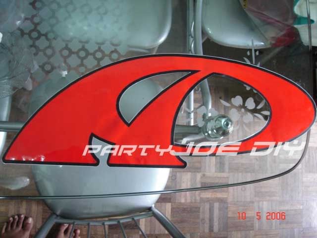

once finish first cutout, stick on to the black sticker n cut again wit a 4-5mm gap.

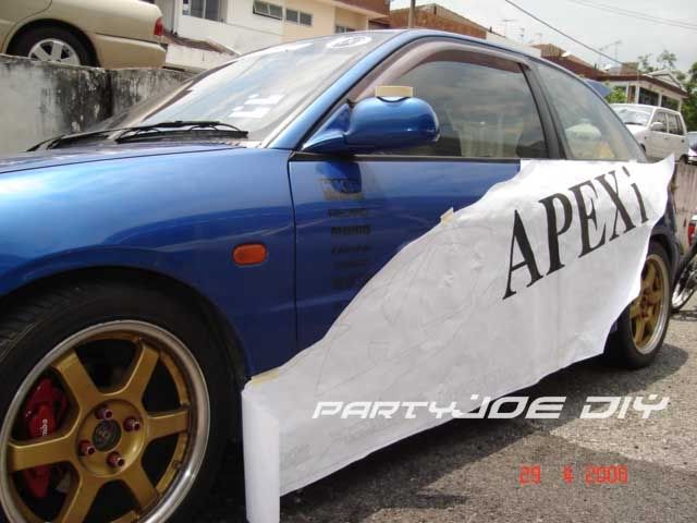

once complete cutting out every piece... stick on wit masking tape to c how it looks.

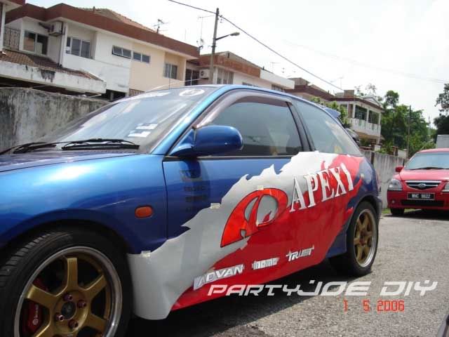

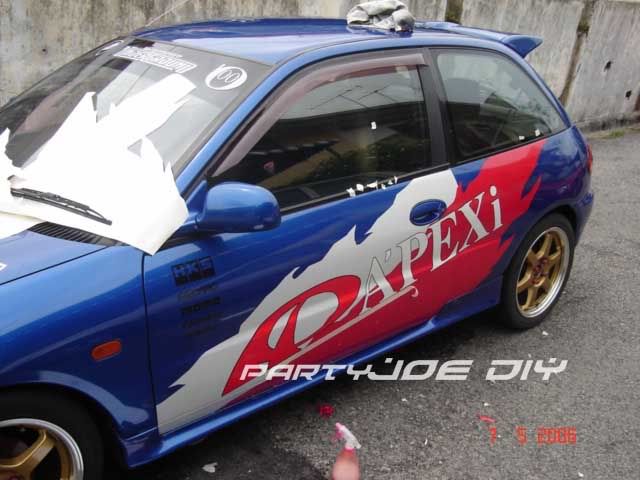

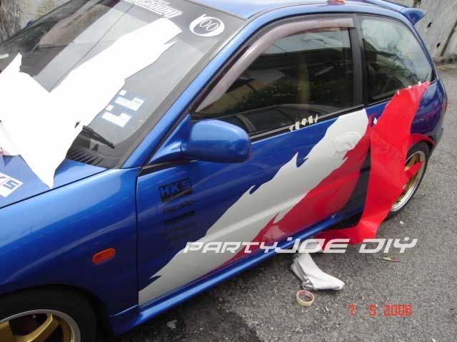

then proceed sticking it... clean surface properly... make sure no sand particles sticking to it... first cut out door piece first.... then spray soap water to surface... peel sticker off n spray soap water on it as well.. stick to surface n adjust... then use the plastic scrapper n drain out the air bubble n soap water off the sticker... repeat until all bubble are out... if stil there use a pin...

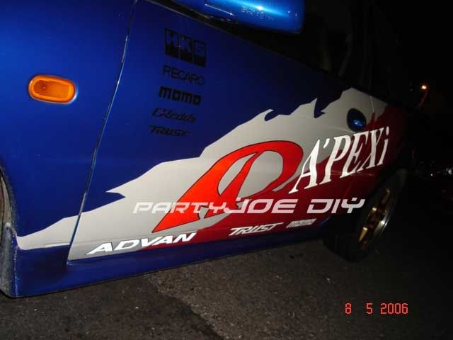

one side almost done... took me almost 3 hours... sighhh... its more tougher then i tough it wud...
after another 2 hour plus... got the the other side done as well... job completed...

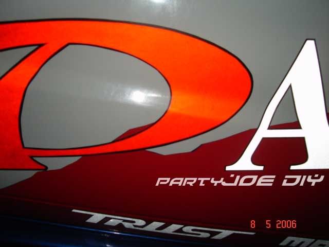

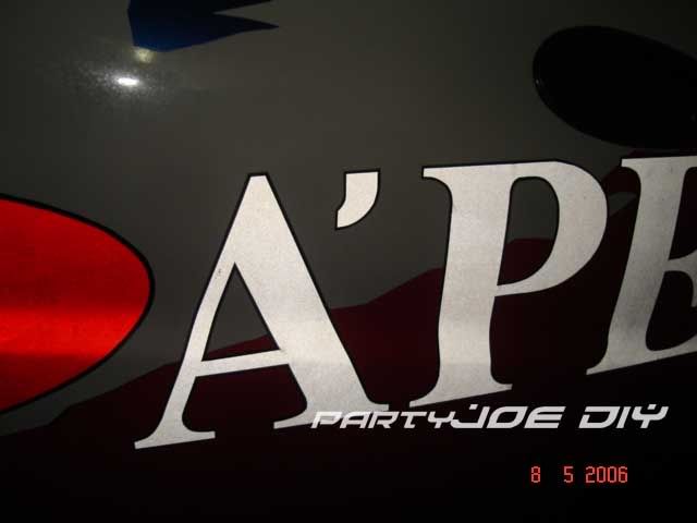

close up shot on the detailing

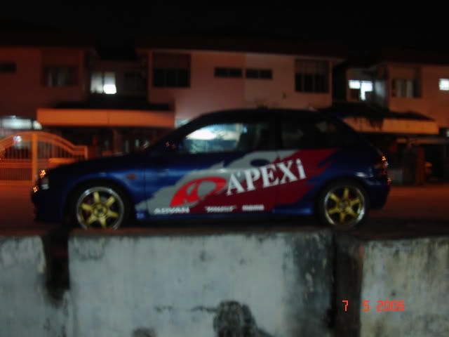

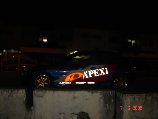

nite shots... glow in the dark... hope no cops wil stop me...

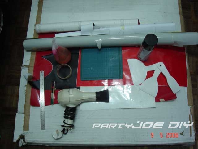

needed items
1. vynil stickers- bought from Arcrylic Signage in Pasar Rd...
i) red - 2.5 m
ii) light grey - 2m
iii) reflective white - 1m
iv) reflective red - 1m
v) black matt finish -1.5m
2. Blade (nt cutter)
3. spray mount
4. cutting mat... cardboard box use as big cutting mat
5. steel ruler
6. plastic scrapper
7. soap water in spray nozzle bottle
8. hair dryer
9. masking tape
n above all dat u need a pair of artistic hands... looks familiar ha..... WCC style.... hahaha

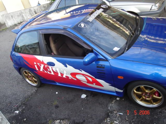

Whoah! Very cool! How come the word Apexi is reversed on the right hand side of the car?
i think its common practise on most designs on show cars...
