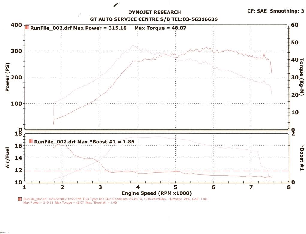

On the other issue of HP for the 2002 model, bro, when you dynoed, the figures you got, are they on wheel HP or on crank HP.
For example in the case of the Dyno at GT Auto, it is on wheel HP.
I can show you a dyno chart of a RA R
Those figures are on wheel HP.
Manufacturers are quoting on crank HP, which is much higher than on wheel HP, typically you are looking at a 20% loss on drive train, for Auto's is even worse.
So based on your figure 253HP on wheel, you would be looking at 316HP on Crank which is even higher than the new 300 BHP Rev Up Motor. And if you are getting 280HP on wheel you would have
350HP on Crank (Awesome)
I hope that made your day:idea:

i've check dat it was 280WHp...i missunderstanding...280hp dat stated in my Z spec is crank HP..
btw, really much thank you for the info..i'm fully understand now about hp issue...now i'm getting to know more about my car...:smile:
