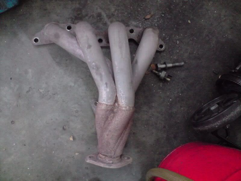

hmmm..changine to 4-2-1 make my whole engine power band go smooth lor ...tats wat i can share..got a BT stock extractor wan to let go....anyone wan ? letting it go cheap lah ..dun wan put under my bed d...

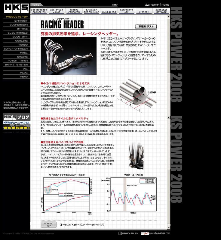

bt extractor is way bigger then that of St...there'sa few option of extractor for 20v such as
1.HKS 4-2-1
2.HKS 4-4-1
3.Apexi GT spec 4-2-1
4.Apexi Spiral 4-2-1
5.FGK 4-2-1
6.RS*R 4-1
7.Cusco Powerball 4-1
8.Tanabe 4-2-1
i've tried around 3 extractors above, and i find that Apexi Spiral 4-1 is the best..hehe:biggrin:
I tot tis hks is 4-2-1... Or just consider 4-1 cause da 2 part so short..
N spiral not 4-1 meh?? Curious...

aiyoyo....
sorry bro jim,i salah letak...apexui spiral is 4-1..i myself use it..salah type hehe..corrections done.wah hks looks damn nice!
Bro, pic shown here is a HKS 4-4-1, using 1 now....pretty good compared to FGK 4-2-1 :burnout::burnout:
