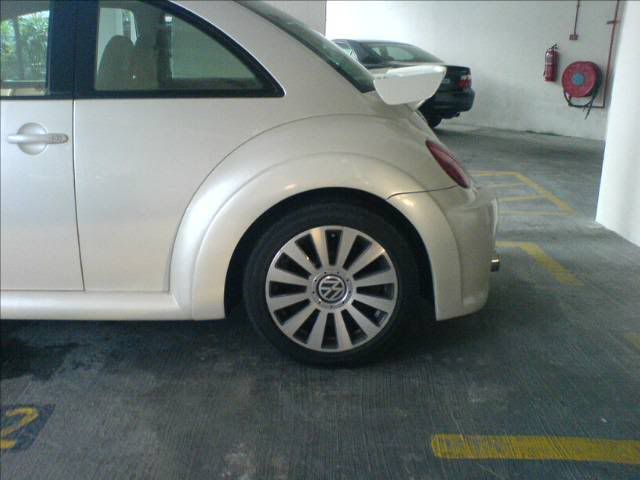

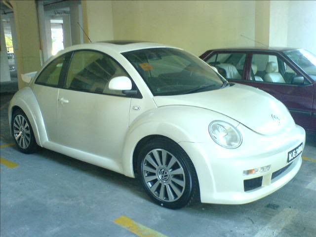

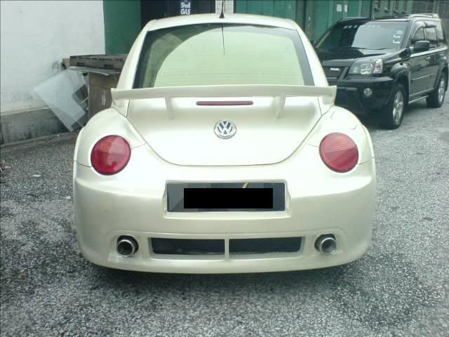

let me share some of the new beetle's picture with rs bodykit..
