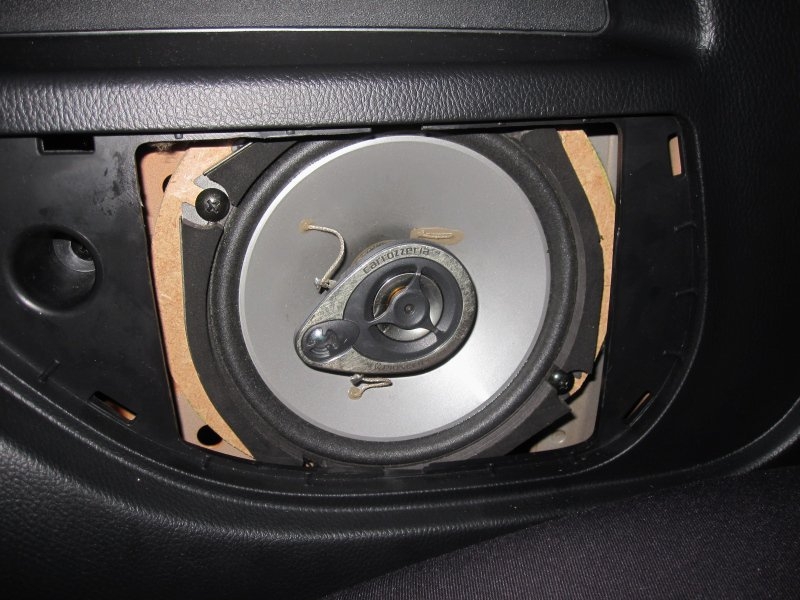

i am using 6.5" carrozzerias at the front and rear.. no modification needed except for creating a new speaker bracket for both pairs..
attached is the picture of the rear speaker..
do u still use stock rear speaker cover?
Ahh nice nice.. exactly what i was hoping for.
So 6.5"s front and rear should be fittable eh! thanks!
