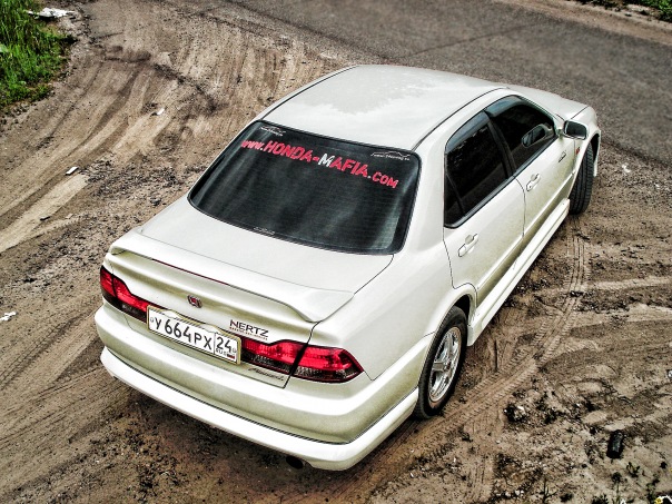

hello guys, show still photos of your cars, it is very interesting to look.
it is possible where the motor and salon.:ciao:
that summer :)
