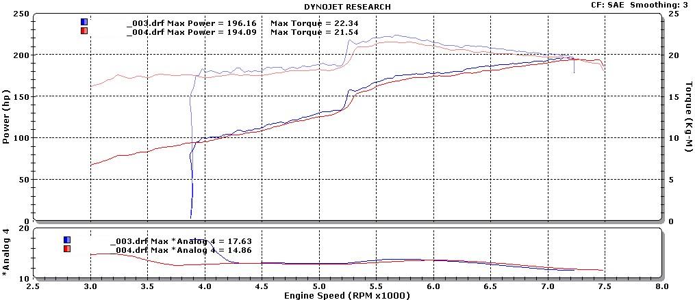

Dyno reading as below for 1st & 2nd time...
good:biggrin: how is the fc now.. ?? but why didnt you wait for the extractor?? its already at eric's shop..
care to share the results or even better, the dyno chart?
1st time dyno run at 185.09hp with 20.48 torque.
2nd time dyno run at 194.09hp with 21.54 torque.
Just wondering with E-Manage (blue) can help to push up to 200hp on wheel?
Need another 6hp to geth 200hp.......
yesterday change extractor at eric shop,fill got more and faster respond........my next planing s90 oversize throttle + skunk 2 black series intake manifold........:slug:any suggestion?????
power will definitely be much better.. but expect rough idling and jerking in a worst case scenario..
---------- Post added at 01:34 PM ---------- 6 hour anti-bump limit - Previous post was at 01:31 PM ----------
sil.. i cant see the readings bro..
Bro Fairy,
This is the reading.
2nd time dyno run at 194.09hp with 21.54 torque. (After install aftermarket 4-2-1, NGK plug cable & NGK plug)
If next step with E-Manage, do you think can hit 200hp on wheel???

some nice figures.. but did you do them at n1? anyway, if you could post the chart up for us it would be good, so i can see the 1 of the most important things.. the a/f ratio.. call me at 0123130100 for more info on ecu.. panjang cerita..

nice figures? Still can't beat your ex-beast 21+ hp on wheel.... Haha... Post it here? Malu la...
Maybe the next Genting trip we can meet up & we talk talk about it. You still joining the CF4 TT?
The Max* Analog = 14.86. I think this is the figure for the a/f ratio.
Hopefully when I install the E-Manage next time, will push up to 200hp on wheel....:biggrin:

by the way you explained the hp, i think you did the run at n1.. just have a look at the top right of the page and see whether its smoothing sae or std.. the af is usually the line below the chart... 14.86 i hope not cos thats lean bro.. other sifu's pls correct me if i'm wrong.. reason for wanting to look at the af line is to see whether you can push forr 200hp.. faster get management:nurse::nurse:.. racun.. hehe

It's SAE. I know 14.86 is lean but it's sames goes to all my previous car when I do dyno run without management. I think this reading is beginning of 3000rpm. Towards 4000rpm onwards, it should be 12+ to 13+...I heard the best AF should be 12.5. Right?
But I am sure after we have mod all those extractor, open pod, piping & etc without management, our car surely will be lean as stock ECU cater for stock car setup. Am I right?
Management I am thinking of E-Manage Blue but budget constraint le bro. Maybe in end Feb....Hehe..
If intall E-Manage Blue, do we need to install Walbro fuel pump & SARD fuel regulator? Or stock will be more than enough...
Anyway, thanks for your info... Below is the Dyno Chart. Possible to reach 200hp on wheel?

this is the dyno chat...with stock a/filter,exhaust.....
Who have tested H22A CL1 max top speed? I tested yesterday but the road not long enough. 220 only. Can reach higher :confused:
stoichiometric a/f ratio for sae is 14.7, anything higher is lean, not good for engine health, lower is rich, and yes, in proper tuning, u need ur a/f a lil bit rich and to do that, u need walbro or any other afteraket ones, and to compliment that, u need at least one additional injector harness or fuel regulator or both...but bear in mind, any piggyback ecu tends to do a closed loop a/f, meaning whatever the tuning was made, our stock ecu still tends to go back to 14.7....still okay, but if u can feel while merembat that ur engine suddenly jerks, just pull ur leg from the accelerator..that's all

stoichiometric a/f ratio for sae is 14.7, anything higher is lean, not good for engine health, lower is rich, and yes, in proper tuning, u need ur a/f a lil bit rich and to do that, u need walbro or any other afteraket ones, and to compliment that, u need at least one additional injector harness or fuel regulator or both...but bear in mind, any piggyback ecu tends to do a closed loop a/f, meaning whatever the tuning was made, our stock ecu still tends to go back to 14.7....still okay, but if u can feel while merembat that ur engine suddenly jerks, just pull ur leg from the accelerator..that's all[/QUOTE]
Bro Alwhi,
Are you saying that whatever piggyback ECU we use, even tuner set the A/F to 12.5 (example), our stock ECU still will back to 14.7 A/F? Then what's the point of we install the piggyback? Confused here... :confused:
