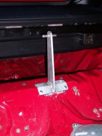

but anyway, fitting EG6 rear seat to EH require mods to the center seat bracket. this pictures will get you clear on this.
if not mistaken, the EG6 center seat bracket is taller than the EH. the solution is to mod the bracket so the rear seat can be fitted nicely. another solution is to manufacture a custom bracket. this pic shows one of good quality custom bracket.
also, there's a bar mounted on the EG6 seat bracket, which supports the rear cargo box. this bar is not present on the EH seat bracket. and again, mods are needed to mount this bar (if u also have the bar).

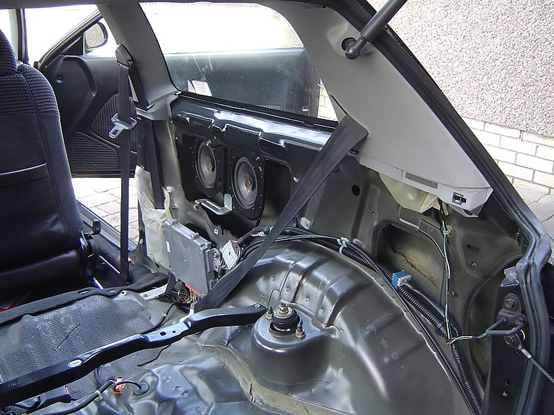

EG6.
Non EG6.
oh... i wonder why the ECU is located there. why ah bro shiro? this one rare one ah? haha!
